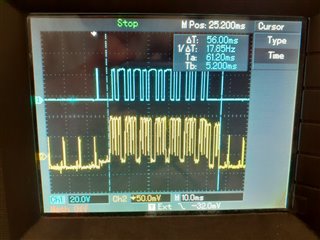

    I try to achieve high throughput via BLE connection between two nRF82540dk boards.
    Have you seen the throughput test results in the SoftDevice documentation? It details which parameters was used during the tests, to reach the different throughput speeds.
    I would like to maximize duty cycle of transmission in the connection interval.
    3) NRF_SDH_BLE_GAP_EVENT_LENGTH = 6
    Please change your event length to allow for more notifications being sent every connection event.
    Since you are only holding a single connection, you can use the entire 'duty-cycle' of the connection interval for this connection.
    You thus may set your event length to 500 (or any other high number), to allow for the event to span the entire interval, if needed.
    Could you also confirm for me that connection event length extension is configured in your project?
    It is default in all newer SDK versions, but I do not know which version you are working with. You might find this answer by my colleague helpful, for an explanation of the parameter.
    You may also find the online power-profiler useful to have a look at, to visualize how the different connection settings will affect your radio usage.
    Please try this, and let me know if you achieve the sought-after radio usage.

  • Hi Karl,
    Yes, I saw the documentation, it reports 1.4Mbps, I have only 250kbps.
    In my configuration Connection Interval is set 7.5ms, and NRF_SDH_BLE_GAP_EVENT_LENGTH = 6 (i.e. 6x1.25ms = 7.5ms) hence I assigned whole interval for communication. The chip should transmit with almost 100% duty cycle, but it doesn't.
    As you saw on the oscillogram above setting of the event length is not effective. The SoftDevice transmits mostly one packet in the cycle.
    What I am doing wrong?

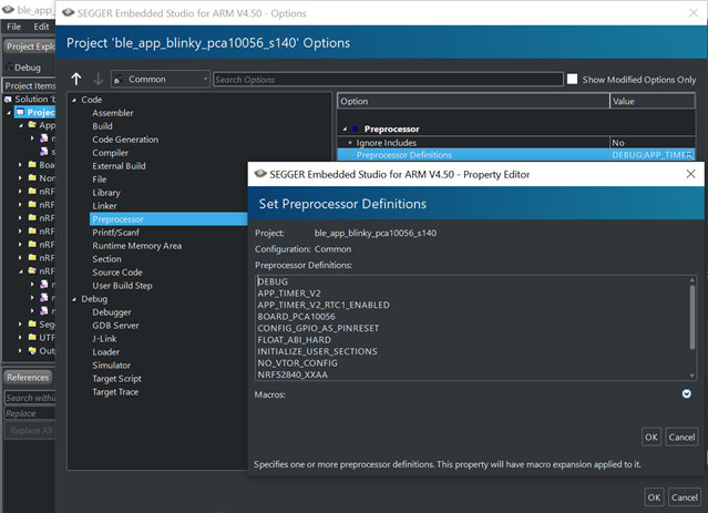

  • Hi Karl,
    I did not try yet RAM adjustment.
    Can you send me exact expression that I should write into linker window options?
    I browsed source code including linker script and I am really confused.
    I very concerned that the same problem (i.e. with memory) exists in Nordic original example (ble_uart project) without any modification. I plan to open new case for that, because it is basic code and is not influenced by any my changes.
    I am very worried that I stuck in some basic issue, that further coding depends on. We are sending one message per day.
    I am sending you private messages in chat window. I am not sure if you receive them?
    Maybe chat will be faster to determine the cause of the problem.
    Piotr Romaniuk

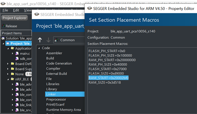

  • Hello Piotr,
    I have attached an image that shows how it should look for you, after you have made the RAM start changes. The exact expression is the same as written in the warning in your log, and the location can be found by right clicking on the 'Project' in SES project explorer, selecting 'options', selecting 'Common' configuration, opening the 'Linker' tab, and double clicking on the 'Section Placement Macros'. Make sure to click OK to close all windows, once you have made the changes.
    Please do this, and let me know if it resolves your error.

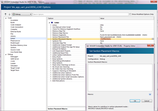

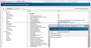

  • Hi Karl,
    I was confused with linker macro window because it was inherited in my IDE:
    Where the linker options are inherited from?
    Your suggestion to setup RAM_START solve the problem:
    I was able then to increase the event length.
    Above oscillogram is for ConnInterval=7.5ms Edges on top (blue) signal are moments of passing packets to BLE stack.
    If I increase ConnInterval (e.g. 10ms, 50ms) still no more than 4 packets are transmitted in one chunk.
    What is the reason for that? Looks like some queue is filled up or temporary missing resources (dynamic memory).

  • Hi Karl,

  • Hello again Piotr,
    Please do not mark this case as solved yet. Above question is still opened.
    Do not worry, it is you yourself that needs to mark an answer as the solution to your problem.
    I would not not close the case until the issue(s) are resolved, and for future reference you also always have the option to re-open tickets that have been closed.
    I am literally here to help, and I am happy to do so.
    I am happy to hear that this resolved your issue, Piotr!
    Piotr, I think a lot of this confusion could have been avoided if you had read the steps I wrote out more carefully. I specifically mentioned the 'common' configuration twice, and it is also visible in the screenshot I sent you.
    The 'debug' build configuration (which you are editing in your screenshots) inherits from the 'common' build configuration that I have asked you to modify. The common build configuration is the core of the project, which all other configurations inherits from. The reason why you must make the change in the common configuration, is because currently only your debug configuration will work (because it is the only one with the proper RAM_START macro).
    So, once you switch to the 'release' configuration, your project will break again.
    Please see the steps I wrote out earlier, or the screenshot I attached. In the upper left corner of the options window there is a drop down menu, which in your pictures says 'debug'. Click this, and change to common, and make the RAM_START changes there.
    This is great! Glad to see that it produced the desired and expected results.
    By this, do you mean that the blue channel indicates calls to 'ble_nus_data_send', for queueing of data to be transferred?
    If so, what does the length of the toggle indicate?
    Yes. It is toggled every time when ble_nus_data_send() returns something else than NRF_ERROR_RESOURSES, see below:
        for(i = 0; i < 30; i++){
            data_array[1] = '@'+i;
            do
                uint16_t length = (uint16_t)index+1;
            nrf_gpio_pin_toggle( pin_dbg2 );
    The length of the signal levels between edges corresponds to periods when above code is not active or is spinning in while - means waiting for the BLE stack untill it accepts a packet for transfer. Looking to oscilogram, one can see that it is synchronized with transmission, hence my conclussion about some queue capacity inside the stack. Also returning code NRF_ERROR_RESOURCES suggests that some resources are not available.
    Ah, yes, I remember this now. Thank you for clarifying, this is very helpful information.
    Looking at the oscilloscope picture you sent earlier, it then seems to me that the radio is in fact being used for the entire connection interval length - given that the picture was taken while using a 7.5 ms connection interval.
    Regarding that only 4 packets seem to be sent per 50 ms interval, this is then the problem we are currently looking into?
    It is hard to say exactly what is going on from the oscilloscope screenshot as opposed to a sniffer trace, but it is up to the central to dictate how many packets actually will be sent each event, since the central has to prompt each and every one of the packets.
    The returned NRF_ERROR_RESOURCES from sd_ble_gatts_hvx just means that the queue is filled up with data queued for transfer, so this is alright in your case.
    Could you take another oscilloscope screenshot of the test you are conducting, taken from the central side, using 50 ms connection interval?
    It would be interesting to see whether the central stops prompting for more packets.
    How many transfers of how many bytes is successful each interval?
    These are all things that would be easy to see in a sniffer trace, but we will try to make due with the oscilloscope pictures to understand what is happening.
    In case the the oscilloscope screenshots prove futile for debugging this issue, you could download the nRF Connect application for Smartphones on your phone, and use that as a central connected to your peripheral device. This way, you should be able to use the freed up device as the sniffer, and produce a sniffer trace of their communication.
    Yes, it is much better, but you can observe a gap every 4 packets.
    I suspected that more cannot fit into such a small connection interval, so I tried to increase that parameter.
    Unfortunatelly, still and only 4 packets were transmitted every one cycle.
    It looks like there is another limitation.
    There will be 4 packets at the begining of the cycle, then long gap to next cycle. Each packet is 244 bytes long on data payload.
