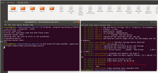

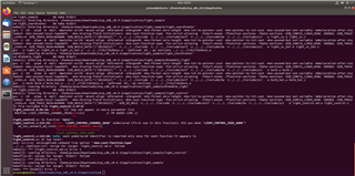

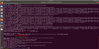

    Understood. Thank you for your quick reply. I have encountered two problems while testing,
    1. With the help of this link Zigbee: NCP — nRF Connect SDK 1.5.0 documentation (nordicsemi.com) and Readme file under ncp_sdk_v0.9.3. I        tried to test the NCP example. But after completing all the steps under testing, my light control device doesn't join the Zigbee network. It doesn't show any led indication on board.
    2. Also tried to test the (SDK v1.5.0) Zigbee network_coordinator, light_switch,light_bulb example but after building while testing it  light_switch doesn't respond. Doesn't show any led indication and not joined the network. Previously, I tested the same scenario with SDK v1.4.2 its works fine there.
    Is your NCP connected to anything physically? What is running the application?

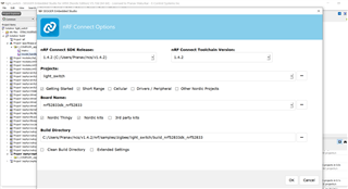

    While comparing both SDK i.e v1.4.2 and v1.5.0 I came to know that path for the light_switch example in v1.5.0 is different than v1.4.2
    v1.4.2 - C:/Users/Pranav/ncs/v1.4.2/nrf/samples/zigbee/light_switch/build_nrf52833dk_nrf52833
    v1.5.0 - C:/Users/Pranav/ncs/v1.5.0/nrf/samples/bluetooth/mesh/light_switch/build_nrf52833dk_nrf52833

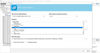

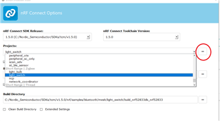

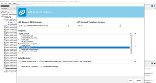

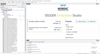

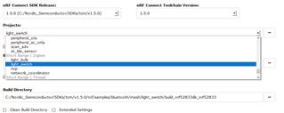

    Thank you for your reply. I think I may not have explained you properly. Sorry for that.
    I have attached some screenshots for proper understanding.
    In the first step, I have imported/selected the light_switch example(under zigbee - light_switch)from SDK v1.4.2.
    In this the path of the example is - C:/Users/Pranav/ncs/v1.4.2/nrf/samples/zigbee/light_switch/build_nrf52833dk_nrf52833

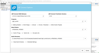

    In the second step, I have followed the same for SDK v1.5.0.
    I have also tried to enter the path manually in v1.5.0. But it also redirects to Bluetooth/mesh.
    I also confirmed this issue with my colleague and the same issue occurred on his pc.

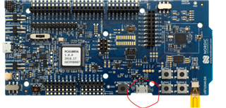

    1. About the NCP example
    I am running the light_control application and NCP connected to my Linux pc. Also tried the same step with my colleague but encountered the same issue.
    Can you please suggest to me some solution by trying it out on your side?
    Thank you,
    Pranav.
  • Oh, I see. When you select zigbee: Light_switch, then the project generator in SES uses the Mesh light switch example:
    Yes. That looks like a bug. Thank you for reporting. I will forward this bug to our developers.
    As a workaround, you can select the project folder manually, using the 3 dots to the right of the projects selecter:
    and select the folder "v1.5.0\nrf\samples\zigbee\light_switch"
    Edvin

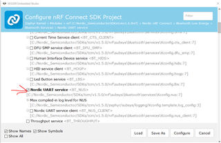

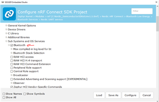

  • Hello Pranav,
    I am not sure what you are trying to point to in your screenshot here.
    Pranav3 said:
    nus_cmd.c file is missing in the project.
     But is it used in the project at all? Have you compared the project config the same way as in 1.4.2? I see that CONFIG_BT_NUS is not enabled by default.
    Try to set:
    And:
    BR,
    Edvin
    Also still I am facing this issue.
    Can you please also help me to resolve this issue?

  • Hello Edvin,
    Thank you for the answer. I will definitely try this.
    Please help me to resolve the “NCP” example issue. It’s been one week am facing the problem.
    I have followed all the steps in the readme file. But still my I am not getting this result,
    “The light control device joins the Zigbee network, searches for a light bulb to control, and starts sending On/Off commands with a 15-sec period that toggles the LED 4 on the light bulb on and off.”
    I have also confirmed the same steps with my college but still facing the same issue.
    Can you please help me to resolve this issue?
    Thank you,
    Pranav
  • I don't understand your NCP example issue. The NCP is a network co processor. What are you using it with? It needs an application CPU running an openthread application, and using the nRF NCP as the radio. What is running your application?
    "I am running the light_control application and NCP connected to my Linux pc".
    What is your linux pc doing then? Is it doing some openthread things? Or do you expect the NCP to create a folder that you can drag and drop applications into? (That is not a serious suggestion, but I try to figure out how you are trying to use the NCP example).
     Where is this written? Can you please point me to the location of this readme file? It looks like you are pointing to the light_switch's readme.rst text, but mine doesn't say that.
