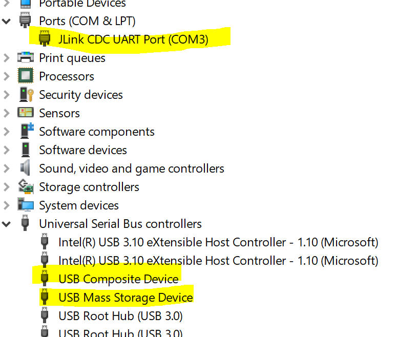

I just recently got both nRF51422 and nRF52844 DK. However, when I tried to connect through J-LINK, the error message popped up: No emulators connected via USB. Do you want to connect through TCP/IP?
I have checked in Device Manager that J-link has showed up under COM port and USB controllers:
So far, I have tried many things individually as following to no avail. I tried on two boards and they appear to be working with LE5 blinking.

  • I am unable to explain this. It is clear that the debugger enumerates as a J-Link from your screenshot from the Device manager, so things should work. Also that you see the same issue even when replacing every component (DK, computer, USB cable) make me puzzled.
    Can you try to remove all Segger related code, reboot, install the nRF Command line tools including segger tools, reboot and then test nrfjprog again? You do not need to do any manual tweaking of drivers etc, it should all work automatically.
