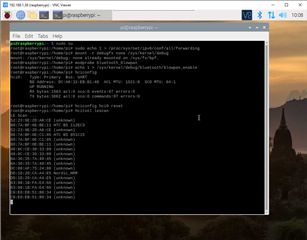

All commands were working fine until echo "connect <mac address of other device> 1" > /sys/kernel/debug/bluetooth/6lowpan_control. As seen from the websites, after this command execution, there should be bt0 interface created. But it is not visible in ifconfig -a.
Also the 6lowpan_control file is empty. But when I try to connect the other device using the command hcitool con after executing the above command, I am able to see the desired connections in the terminal, still no bt0 device available. I have even tried with the command ifconfig bt0 add 2001:db8::1/64 but resulted in the error SIOGIFINDEX: No such device.
How to resolve this problem?

    I can find my nRF52 DK board with this command on RPi 4
    hcitool lescan
    Then also this command works
    echo "connect 00:AA:BB:XX:YY:ZZ 1" > /sys/kernel/debug/bluetooth/6lowpan_control
    After this
    when I tri this command
    ifconfig
    I couldn't find the bt0.
    Of course, I created the RAVID configuration file on the etc folder
    interface bt0
    AdvSendAdvert on;
    prefix 2001:db8::/64
      AdvOnLink off;
      AdvAutonomous on;
      AdvRouterAddr on;
    As you can see, I couldn't connect to nRF DK
    but can't find bt0 interface
    I hope your news
    Thanks

    I tested this out on a RPi4 with the same OS version, and a nRF52840 DK running the IoT CoAP server example.
    These commands works on my end:
    pi@raspberrypi:~ $ sudo -i
    root@raspberrypi:~# modprobe  bluetooth_6lowpan
    root@raspberrypi:~# echo 1 > /sys/kernel/debug/bluetooth/6lowpan_enable
    root@raspberrypi:~# echo 1 > /proc/sys/net/ipv6/conf/all/forwarding
    root@raspberrypi:~# hcitool lescan
    LE Scan ...
    00:F5:E7:B0:90:9A CoAP_SRV
    00:F5:E7:B0:90:9A (unknown)
    root@raspberrypi:~# echo "connect 00:F5:E7:B0:90:9A 1" > /sys/kernel/debug/bluetooth/6lowpan_control
    root@raspberrypi:~# ifconfig bt0
    bt0: flags=4161<UP,RUNNING,MULTICAST>  mtu 1280
            inet6 fe80::dca6:32ff:fe36:5978  prefixlen 64  scopeid 0x20<link>
            unspec DC-A6-32-36-59-78-00-00-00-00-00-00-00-00-00-00  txqueuelen 1000  (UNSPEC)
            RX packets 1  bytes 28 (28.0 B)
            RX errors 0  dropped 2  overruns 0  frame 0
            TX packets 19  bytes 1783 (1.7 KiB)
            TX errors 0  dropped 0 overruns 0  carrier 0  collisions 0
    root@raspberrypi:~# ping -6 fe80::dca6:32ff:fe36:5978
    PING fe80::dca6:32ff:fe36:5978(fe80::dca6:32ff:fe36:5978) 56 data bytes
    64 bytes from fe80::dca6:32ff:fe36:5978%bt0: icmp_seq=1 ttl=64 time=0.132 ms
    64 bytes from fe80::dca6:32ff:fe36:5978%bt0: icmp_seq=2 ttl=64 time=0.085 ms
    64 bytes from fe80::dca6:32ff:fe36:5978%bt0: icmp_seq=3 ttl=64 time=0.073 ms
    64 bytes from fe80::dca6:32ff:fe36:5978%bt0: icmp_seq=4 ttl=64 time=0.070 ms

  • Hi, Jorgen. Thanks for your effort
    Really great! , You got the "bt0" on Rpi 4 and Raspberrian OS.
    You gave me the conviction of my project!
    However, Very strange. I still can't get the "bt0" interface.
    I really don't know where is the issue
    now I am thinking perhaps there is some issue with this RAVID installation.
    interface bt0
    AdvSendAdvert on;
      AdvOnLink off;
      AdvAutonomous on;
      AdvRouterAddr on;
    I am not sure this conf file installed correctly.
    Anyway, I followed the guidance of this installation.
    Did you also install this RAVID conf file on your RPi 4?
