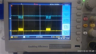

Watermark interrupt not working correctly with nrf52832 due to spi overhead
-I have a custom board using nrf 52832 and I have interfaced LIS2DH12 using an SPI interface.
-I am using SDK 15.2.0.
-I am collecting raw data using FIFO mode and send them serially.
-I have configured watermark interrupt on INT1 of Lis2dh12.
-INT1 pin of Lisdh12 is connected to pin P0_19 of nrf 52832.
Whenever Watermark interrupt occurs I have read raw data from the lis2dh12 sensor. After reading raw data from FIFO I read FIFO_SRC_REG. It has been observed that for first-time watermark interrupt occurs its value is 10 i.e un-read sample. For the next watermark interrupt its value is 28 and next its value is 29.
I have performed some calculations as follows.
SPi Freq 4000000
Time for 1 bit 0.25us
Time for 1 byte 4 us
No of byte per acc value 12us
Time to transfer to read 1 FIFO value 48 us.
AS per my understanding as I am using baud rate 4 MBPS for SPI then for the first watermark interrupt its value should be 2 then it is multiple of 2. I think there is some SPI overhead due to this I am getting a value of 10 instead of 2.AM I right? .
What is the reason for this behavior?

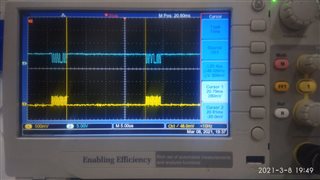

I have captured the SPI clock and SDI pin waveform and attached it herewith.
Clock - Yellow
  SDI - Blue
A snippet of code as follows

  • The watermark register is being set to 10, and so the number of data samples waiting (register bits FSS[4:0]) when reading following the interrupt will be at least 10, which I think is what you have (if you read the FIFO status before reading XYZ values out of the FIFO) ie not 2. It could be more than 10 depending on how long the code takes to eventually read the FIFO status, but following a 10-reading readout it should not go active again until the next 10 samples have been accumulated in the FIFO; FIFO overflow should probably be handled; unexpected results might occur otherwise.
     spi_write_reg(LIS2DH_FIFO_CTRL_REG, 0X8A); 	// FIFO MODE -STREAM ENABLE AND NO SAMPLE 10
    Usually the 12-bit XYZ registers - which occupy  consecutive bytes on the LIS2DH12 - would be read in a single multi-byte SPI transfer; not quite sure if there is an issue reading just 1 byte at a time.
    By the way, using high-drive on /CS, SCK and MOSI allows 8MHz operation.
    Note if 10 readings are read out then the FIFO status no  longer has those 10 readings to report, and might indeed report 1 or 2 depending how long the code took. Better to read status both before and after reading out the FiFO to see what is happening.
  • I think is what you have (if you read the FIFO status before reading XYZ values out of the FIFO) ie not 2
    => yes if I have read FIFO status before reading XYZ values out of the FIFO then the first time it is 11 i.e watermark interrupt occurs. For next time it is 29.
    =>I want to read multiple bytes at a time i.e 12 byte Can you tell me how to read it using nrf spi driver.
