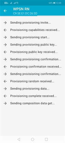

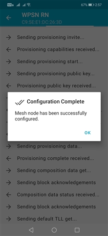

I have tried adding UP TO 4 Property IDs (and up to 4 descriptors), everything is working fine, i.e. able to get through provisioning and configuration successfully and work fine with sensor_client app to send the descriptor msg for all property ids and other test (per the sensor example)
Problem statement:

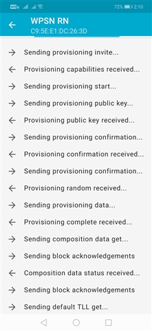

When the number of Property ID is increased to 5, during provisioning (using nRF Mesh Android app) process,  even though sensor_server is able to go through provisioning successfully (Note: On nRF Mesh mobile app: "<- Provisioning complete received" is shown) but it consistently failed/stopped at the "composition data get" step (Pls see nRF Mesh's  screenshot below)
I have repeatedly tried with 4 and 5 Property ID builds for several times and verified that the build with 4 Property ID is always OK in all aspects but for the build with 5 Property ID, the nRF Mesh always failed at the " -> Sending composition data get .." step.
Some debugging info:
1. I have put in some log message in handle_composition_data_get in handle_composition_data_get() (in config_server.c) and noticed that the function runs ok all the way till the end (i.e. app_evt_send(&evt).
2. The handle_config_default_ttl_get() is not invoked for the case of 5 Property ID
This is unclear to me the issue lies with nRF52840 firmware or with the nRF Mesh mobile app.
Pls advise what needs to be done to make the sensor_server_model capable of supporting 5 Property IDs (for 5 sensors).

  • It seems like the access layer couldn't allocate the packet using mesh_mem_alloc as it returned NRF_ERROR_NO_MEM.
    I suggest you to increase PACKET_MGR_MEMORY_POOL_SIZE.
  • Ok, I will try to increase it from 4096 to 5120 and see if it helps to solve. Thanks
    Question: The warning regarding the max size of packet manager memory pool does not seem to reflect the current values used. Pls see text highlighted in red below.
    Can you advise what value of PACKET_MGR_MEMORY_POOL_SIZE should I use?

  • It seems to be a legacy warning and can be ignored. From our developer:
    I think I realised why the number of properties breaks configuration:
    The memory pool size is common for the whole stack. app_sensor_utils.c uses it to allocate cadence for each property id that is defined for the sensor (see app_sensor_utils.c::sensor_initialize and app_sensor_utils.c::cadence_new). Usually, the default value in PACKET_MGR_MEMORY_POOL_SIZE is enough and this problem won't occur. I think, analysing the memory size allocated by app_sensor_utils.c::cadence_new can help them to understand how big PACKET_MGR_MEMORY_POOL_SIZE should be.
  • Hi Mttrinh,
    I tried with increasing PACKET_MGR_MEMORY_POOL_SIZE by 512 bytes to 4608 (in view of the cadence bytes needed ranges from 184 to 212 bytes) but the problem is still there. Pls see attached log that was taken with build with PACKET_MGR_MEMORY_POOL_SIZE of 4608 bytes.

    00>      Button/RTT 2) To publish present battery state value.
    00>      Button/RTT 3) Unused.
    00>      Button/RTT 4) Clear all the states to reset the node.
    00>     ---------------------------------------------------
    00> <t:     763005>, mesh_gatt.c,  241, conn_index_alloc: 0
    00> <t:     784267>, ble_softdevice_support.c,  104, Successfully updated connection parameters
    00> <t:     859335>, mesh_gatt.c,  582, New MTU: 66
    00> <t:     860079>, ble_softdevice_support.c,  104, Successfully updated connection parameters
    00> <t:     923764>, main.c,  656, Device identification started
    00> <t:     923772>, mesh_gatt.c,  168, HVN data: 03010100010001000000000000
    00> <t:     923776>, mesh_gatt.c,  219, status: 0 len: 13 usable-mtu:66 sar_type: 0
    00> <t:     923781>, mesh_gatt.c,  405, Couldn't pop packet from buffer
    00> <t:     935556>, mesh_gatt.c,  405, Couldn't pop packet from buffer
    00> <t:    1024033>, main.c,  665, Device identification stopped
    00> <t:    1029943>, mesh_gatt.c,  168, HVN data: 030320F6D21D158A5087F8AACF9A08D70007EBF8A614BCE1FC6EEC9ADB88ED849489C41C6CD948561CC89432CABC78F8096B163AA7F8221EA3CFA1775154937BB77F
    00> <t:    1029950>, mesh_gatt.c,  219, status: 0 len: 66 usable-mtu:66 sar_type: 0
    00> <t:    1034729>, mesh_gatt.c,  405, Couldn't pop packet from buffer
    00> <t:    1047628>, mesh_gatt.c,  405, Couldn't pop packet from buffer
    00> <t:    1047651>, mesh_gatt.c,  168, HVN data: 030589D426C6D15B72A0B4EA1A9A29A224AE
    00> <t:    1047656>, mesh_gatt.c,  219, status: 0 len: 18 usable-mtu:66 sar_type: 0
    00> <t:    1047661>, mesh_gatt.c,  405, Couldn't pop packet from buffer
    00> <t:    1059424>, mesh_gatt.c,  405, Couldn't pop packet from buffer
    00> <t:    1059439>, mesh_gatt.c,  168, HVN data: 0306797F07105D5B275750AB4386E5400E6A
    00> <t:    1059444>, mesh_gatt.c,  219, status: 0 len: 18 usable-mtu:66 sar_type: 0
    00> <t:    1059463>, mesh_gatt.c,  405, Couldn't pop packet from buffer
    00> <t:    1071219>, mesh_gatt.c,  405, Couldn't pop packet from buffer
    00> <t:    1071248>, mesh_gatt.c,  168, HVN data: 0308
    00> <t:    1071252>, mesh_gatt.c,  219, status: 0 len: 2 usable-mtu:66 sar_type: 0
    00> <t:    1071298>, config_server.c, 3205, config_server_bind
    00> <t:    1071304>, mesh_gatt.c,  405, Couldn't pop packet from buffer
    00> <t:    1083008>, mesh_gatt.c,  405, Couldn't pop packet from buffer
    00> <t:    1112509>, mesh_gatt.c,  256, conn_index_free: 0
    00> <t:    1113399>, main.c,  671, Successfully provisioned
    00> <t:    1113404>, main.c,  731, Node Address: 0x0002
    00> <t:    1113411>, main.c,  937, Battery voltage (mV): 348, Battery level: 0%
    00> <t:    1113437>, main.c,  974, LIS3DH X,Y,Z: 333333333333
    00> <t:    1208051>, mesh_gatt.c,  241, conn_index_alloc: 0
    00> <t:    1208053>, proxy.c,  633, Connected
    00> <t:    1227196>, ble_softdevice_support.c,  104, Successfully updated connection parameters
    00> <t:    1302059>, mesh_gatt.c,  582, New MTU: 66
    00> <t:    1303043>, proxy.c,  671, TX ready
    00> <t:    1303053>, mesh_gatt.c,  168, HVN data: 0101005DAA5C7F71415CC800000000F16F51282A272B07
    00> <t:    1303058>, mesh_gatt.c,  219, status: 0 len: 23 usable-mtu:66 sar_type: 0
    00> <t:    1303063>, ble_softdevice_support.c,  104, Successfully updated connection parameters
    00> <t:    1303067>, proxy.c,  684, TX complete
    00> <t:    1303069>, mesh_gatt.c,  405, Couldn't pop packet from buffer
    00> <t:    1319300>, mesh_gatt.c,  405, Couldn't pop packet from buffer
    00> <t:    1378304>, proxy.c,  676, RX
    00> <t:    1378310>, proxy.c,  607, RX GATT PDU type 0x0, len 21
    00> <t:    1378325>, access.c,  253, RX: [aop: 0x8008]
    00> <t:    1378327>, access.c,  276, RX: Msg: FF
    00> <t:    1378329>, access.c, 1087, cmp_id: 0xFFFF mdl_id: 0x0000  alloc? 1  addr_match? 1  key_bound? 1  opcode? 1
    00> <t:    1378335>, config_server.c,  898, composition_data_get:: 590000000000280007000000050000000200001101110C10
    00> <t:    1378339>, config_server.c,  205, access_model_reply status: 4
    00> <t:    1378342>, access.c, 1087, cmp_id: 0xFFFF mdl_id: 0x0002  alloc? 1  addr_match? 1  key_bound? 0  opcode? 0
    00> <t:    1378347>, access.c, 1087, cmp_id: 0xFFFF mdl_id: 0x1100  alloc? 1  addr_match? 1  key_bound? 0  opcode? 0
    00> <t:    1378351>, access.c, 1087, cmp_id: 0xFFFF mdl_id: 0x1101  alloc? 1  addr_match? 1  key_bound? 0  opcode? 0
    00> <t:    1378356>, access.c, 1087, cmp_id: 0xFFFF mdl_id: 0x100C  alloc? 1  addr_match? 1  key_bound? 0  opcode? 0
    00> <t:    2096447>, main.c,  937, Battery voltage (mV): 336, Battery level: 0%
    00> <t:    3079487>, main.c,  937, Battery voltage (mV): 336, Battery level: 0%
    00> <t:    4062527>, main.c,  937, Battery voltage (mV): 336, Battery level: 0%
    # Logging stopped @ 27 Mar 2021  8:33: 6
    Pls help to investigate again and advise what else needs to be modified. Thank you.
    My apologies, it seems like the problem was elsewhere.
    The problem is that for SES projects we set heap size to 1024 bytes: https://github.com/NordicSemiconductor/nRF5-SDK-for-Mesh/blob/master/CMake/SES/SESGenerator.py#L165
    Set arm_linker_heap_size to 2048 in .emProject file and that will solve it.
  • Hi Mttrinh,
    Increasing the heap size to 2048 does help to resolve the issue. Thanks for your great help and support!
