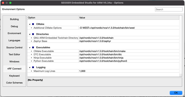

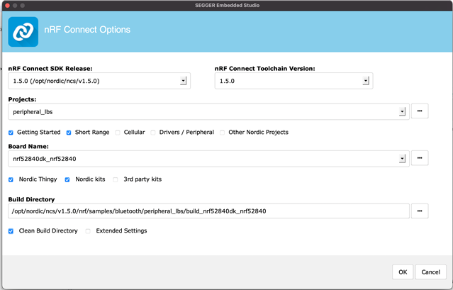

Here is my debug from Segger Embedded Studio when attempting to create a project using the Toolchain Manager installed toolchain:
Creating solution peripheral_lbs.emProject
/opt/nordic/ncs/v1.5.0/toolchain/bin/cmake -GNinja -DBOARD=nrf52840dk_nrf52840 -DBOARD_DIR=/opt/nordic/ncs/v1.5.0/zephyr/boards/arm/nrf52840dk_nrf52840 -B/opt/nordic/ncs/v1.5.0/nrf/samples/bluetooth/peripheral_lbs/build_nrf52840dk_nrf52840 -S/opt/nordic/ncs/v1.5.0/nrf/samples/bluetooth/peripheral_lbs -DNCS_TOOLCHAIN_VERSION=1.5.0 -D WEST=/opt/nordic/ncs/v1.5.0/toolchain/bin/west -DEXTRA_KCONFIG_TARGETS=menuconfig_ses -DEXTRA_KCONFIG_TARGET_COMMAND_FOR_menuconfig_ses=/Applications/arm_segger_embedded_studio_v534a_macos_x64_nordic/html/configure_nordic_project_menuconfig.py
