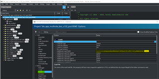

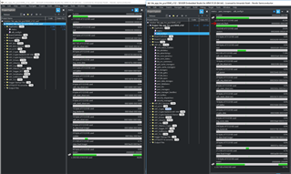

  • I cleared the memory and it works fine now.
    Even though it works, I have noticed that this serialized code (270k) is bigger than the original one (240k). The serialized code should have no software device code.
    When I modified the code to serialized, I had removed "SOFTDEVICE_PRESENT".
    Anything else should I do?
    Thank you for your help
    The original example doesn't build and include the softdevice. In another word, the original one (240k) is the application without the softdevice. You need to load the application and the softdevice images to make it work, and segger will do that with the setting. Therefore, I guess adding serialization lib might make the size large than the original one. You might look into sdk_config.h and disable the configurations related softdevice if you are pretty sure the softdevice is not used.
    -Amanda H.

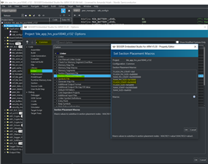

  • You said: "You need to load the application and the softdevice images to make it work, and segger will do that with the setting"
    Could you please tell me where the setting is?
    I guess, I build the hex file based on the original project settings and the softdevice image is still in the serialized code, even if it does not use it any more.
    Thank you for your help.
    Segger will load the softdevice when loading the application. You can remove the setting if you don't use the softdevice, but it will not affect the size of the application.
