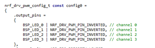

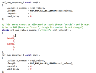

    re: #10, the duty cycle in the PWM HAL is set with counter compare values, so maybe that is where you had gotten it from? I started experimenting with it, and I have a question:
    By default, when I embed it in my own code, it looks like 0 = brightest & COUNTERTOP = off.
    In the HAL example, it was the opposite (0 = off, 0x8000 = brightest). But I cannot tell how this was set. I thought it was via the below code:
    but adding NRF_DRV_PWM_PIN_INVERTED to the pins in my code seem to have no effect at all. For example, setting channel 0 of .output pin to 17 or 17 | NRF_DRV_PWM_PIN_INVERTED both result in 0 = brightest and 32767 = off. I am using a custom board with a separate RGB LED & nrf52840, sdk 14.2. Do you know how I can change it so that 0 is off?
    Also, I saw the example code use 0x8000 (demo 2, seq 1), but I thought the highest that should be possible is 0x7FFF (32767) because only 15 bits are available to set the brightness. How come 0x8000 is valid / possible?

  • Hello Jared, just wanted to follow up on the following 2 questions:
