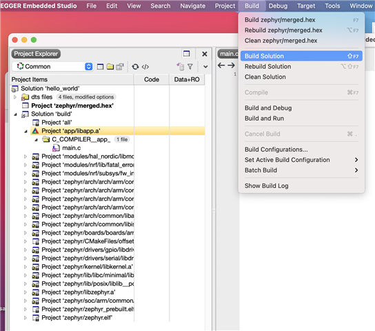

I have a board Actinius Icarus nrf9160 and I'm trying to program with external hex file through nrfConnect sdk and Actinius programmer.
Loading prebuilt example works.
1) I followed step by step the hello_world example. Open nrfConnect sdk project ....
secure or non secure gives anyway the same result.
then I select the project and go to Build Solution.
If I upload now the hex file that I find under /.../hello_world/build_nrf9160dk_nrf9160ns/zephyr/zephyr.hex through Actinius programmer, flashing works fine but the file doesn't work.
Same thing if I download the sample file from Actinius and build the solution through nrf Connect.

  • Hi!
    From your screenshots it looks like you have the nRF9160 DK selected as the target for the build instead of the Icarus. Could you confirm that you actually selected the Icarus (actinius_icarus_ns) from the list during your tests? The "3rd party kits" checkbox needs to be checked, otherwise no board other than Nordic's own boards appear in the board lists.
    Also, are you uploading via JLink or USB (MCUboot)? If it is the latter, you need to make sure that the partitions in your project are the same as what the MCUboot on the board expects, because partitioning changed after nRF Connect v1.3.x (see https://docs.actinius.com/icarus/building/zephyr). If you are using JLink or you have uploaded MCUboot yourself and you are not using the preinstalled MCUboot you can disregard this!

  • Hi Robi,
    The screenshots did not come through, but if I understand correctly you tried to upload merged.hex/zephyr.hex via USB (MCUboot) which indeed won't work. The merged.hex should only be used when uploading with a JLink as it contains all of the hex files together (MCUboot, SPM, Application). When uploading with MCUboot, only the application should be uploaded (that's the "app_signed.hex" that is mentioned in the docs).
