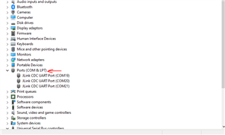

when ever I pressed execute button it is showing unable to connect j link with usb and enter serial number to connect with IP
failed to open dll is showing at output terminal

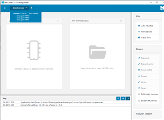

Did you try downloading nRF Connect for Desktop and open the Programmer app? Does it show up there?
Also, what does your Device Manager look like?
