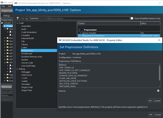

    Please make sure to add DEBUG to your preprocessor defines, so that the logger will output a detailed error message if an error code != NRF_SUCCESS is passed to an APP_ERROR_CHECK. The included image demonstrates where you should add the DEBUG define.
