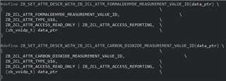

I am trying to set the attributes' value of a custom cluster I have defined.
I have defined 2 attributes:

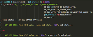

I have followed the same procedure as in the Multisensor example included in SDK for Thread and Zigbee v4.1.0 to set the new value for one of the attributes, in this case, the first one.
But when I use the API function "zb_zcl_set_attr_val()", the status retuned is always "ZB_ZCL_STATUS_INVALID_VALUE". I have tried several possible solutions, but neither of them worked.
Could anyone give me some tips or guidance on what I am doing wrong please?

    You need to also define a custom cluster ID for your clusters, as they do not look to be standard Zigbee clusters from their names. In external\zboss\include\zcl\zb_zcl_common.h you can see that several standard Zigbee clusters are defined, among them the pressure measurement cluster (ZB_ZCL_CLUSTER_ID_PRESSURE_MEASUREMENT), which is defined with ID 0x0403. For standard clusters, this ID can be found in the Zigbee Cluster Library (ZCL) specification, under the "Cluster Identifiers" chapter for each cluster.
    However, since you are using a manufacturer specific cluster, you must use an ID that is not reserved for standard Zigbee clusters, so your ID must be in the range 0xfc00 – 0xffff. This can be found in chapter 2.6.1.3 in the ZCL specs revision 6.

    Yes, as you said, I have defined the custom cluster and assigned an ID in the range 0xfc00 - 0xffff, specifically 0xffee.

    Did you look at the implementation of the pressure measurement cluster, in zb_zcl_pressure_measurement, when creating the custom cluster and declaring the attributes? This cluster is implemented in the application to use as a reference for implementing your own clusters and attributes.
