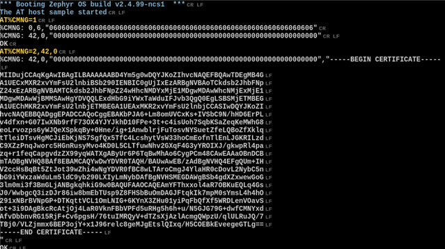

    3. If the X509 certificate is stored in the TLS store, is it possible to read back, or compare it to what is stored on the SD card, if I go with using the SD card as the primary storage location for the X509 certificates I would like to rewrite the certificate stored in the TLS store on startup, but don't want to rewrite it if unnecessary to avoid wear on the EEPROM memory.  Is there logic in the TLS writing logic that would compare what is in EEPROM and only erase/write bytes that have changes (to avoid wear)?  I incorporate similar logic in the Raspberry Pi EEPROM writing logic.
    You can read back Root CA, but not any secret keys. Here's an example where I read back the CA root written by https_client sample:
