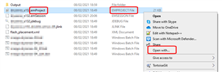

When i build a sample project with nRF connect sdk and segger nordic edition ide, i get a .emProject file.
When i close and open it again by double-click the .emproject file, the normal version of ide opens (not the nordic edition one).
Could you help me is there is any configuration to set, so that when i open the .emproject file, the ide with nordic edition loads up?

  • You must be selecting the wrong binary, then.
    You still have the other options:
    simply open the required app first, and do File > Open from within the app
    I think you can also drag and drop ?
    In fact, I think you have two drag & drop options:
    1. drag & drop onto desktop shortcut;
    2. drag & drop into the open app
    Also, when you open the app, it remembers "recently used" projects - so you don't even have to navigate to them.
