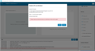

To try to fix this, I was able to flash the nrf52840 with the latest version of the connectivity bridge (thingy91_nrf52_connectivity_bridge_2021-03-04_8e8c6089.hex) by putting it into serial recovery mode - holding down the tiny button. After doing this the Thingy91 shows up in the programmer with a slightly different name than before. It used to be something like PCA0000029 but it is different now (as pictured), which was unexpected.
Next, I attempt to put the nrf9160 into serial recovery mode. When I do this and attempt to flash the modem firmware, I get this:
Please make sure that the device is in MCUboot mode and try again.

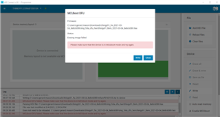

And similarly with the application firmware:
