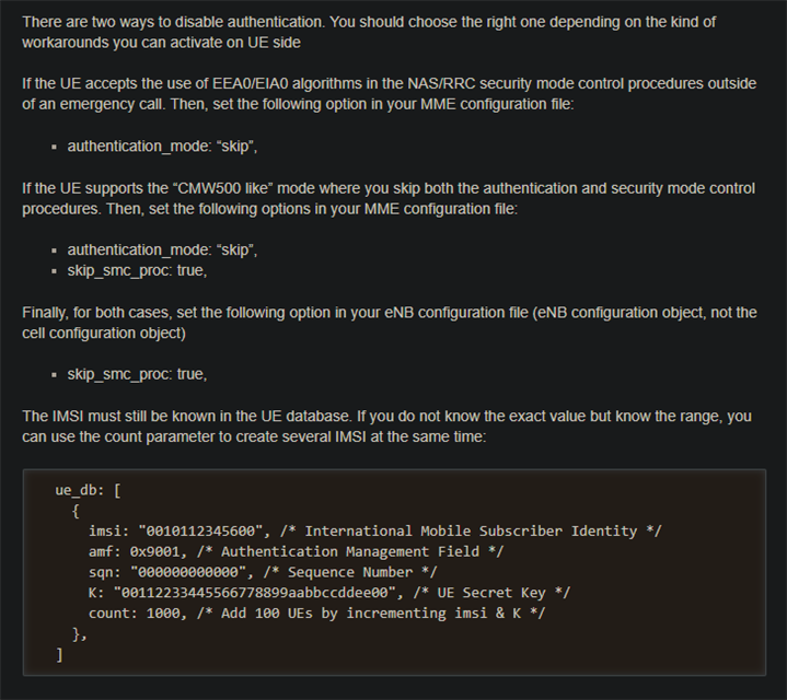

I am currently working on a production test bench for products with nRF9160 and soldered SIM cards.
To test them, I'll connect them to an Amarisoft Callbox mini through LTE-M.
The documentation of the Callbox states that the Authentication should be disabled on UE side in order to be able to connect with commercial SIM cards (not the test SIM cards provided with the callbox).
What exactly should be done on the nRF9160 to achieve that ?

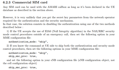

    The same stuff as in my first post is explained slightly differently here:
    What option should be used with the nRF9160 ? The 1) or the 2) ?
    Do you have any idea what "the command at UE side to skip both the authentication and security mode control procedures" might be ?
    Thanks for your support.
