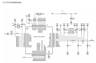

I went through the e73-2g4m04s1b and found out that the xtal is 24mhz, versus the DK has 32mhz xtal. But why this has work before with arduino environment with nrf52dk set as board. Or is there anything I must do with the zephyr code/configurations?

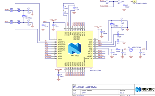

    And here are the schematic for reference.
