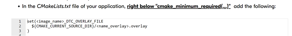

    When building from my SES project, I was specifying the overlay file via the CMakeList.txt file:
    cmake_minimum_required(VERSION 3.13.1)
    set(ThreadsEx_DTC_OVERLAY_FILE
    ${CMAKE_CURRENT_SOURCE_DIR}/ThreadsEx.overlay
    project(threads)
    target_sources(app PRIVATE src/main.c)
    The problem I was having was that 2.2.2 of the Part 2 Tutorial indicates to modify the CMakeList.txt
    I substituted my project name for the <image_name>...but this wrong.
    How do I know what the <image_name> is?  (I'm sure this is a stupic question).
    Mike
  • The code
    set(<image_name>_DTC_OVERLAY_FILE
        ${CMAKE_CURRENT_SOURCE_DIR}/<name_overlay>.overlay
    is used if you want to set an overlay file of a child image from the application. A child image can be mcuboot, or spm. E.g. if you build using nrf5340dk_nrf5340_cpuappns, the child image SPM will get included (zephyr/samples/threads/build/zephyr/merged.hex will contain both the application and SPM image).
    If you then do
    set(spm_DTC_OVERLAY_FILE
        ${CMAKE_CURRENT_SOURCE_DIR}/whatever_name.overlay
    This will be the same as adding it here: sdk-nrf/samples/spm at master · nrfconnect/sdk-nrf · GitHub. The stuff in the overlay file will then be applied to the SPM image.
    If you just want to add an overlay file to your applicatiion, you can just add it like this: zephyr/samples/threads/nrf5340dk_nrf5340_cpuapp.overlay (no need to add anything to the CMakeLists.txt file). If you then build using the same name (nrf5340dk_nrf5340_cpuapp), the stuff in that overlay file will get applied to the application image. It is important to build with the same name as the name of the overlay file.
    (I have not tested it, but I think it should work using the name whatever_name, for the SPM, since you explcitly set it).
    Hope this clarifies stuff.
    Simon

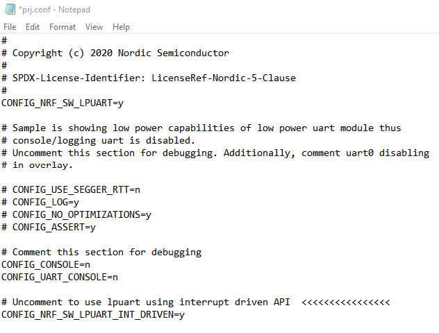

    Back to the subject of this thread:  I still need to configure 2 uarts (in addition to the console) on my dev kit.  I'm searching the sample code for examples and decided to build the ncs\v1.5.0\nrf\samples\peripheral\lpuart example.  I can successfully build this example and can see the uart pins toggle correctly when executing it. I then attempted to build this example to be interrupt driven. I thought I could do this by editing the file below and set the CONFIG_NRF_SM_LPUART_INT_DRIVEN value to yes (per the comment):
    I'm building in SES (mainly because I'm using the debugger to set breakpoints) and reloaded the project and cleaned/rebuilt the solution.  I changed the above file and also the boards\nrf5340dk_nrf5340_cpuapp.conf file in the sample project.   I couldn't hit the ISR breakpoints...or the init driven initialization path.  (i.e. it doesn't look like the CONFIG_NRF_SM_LPUART_INT_DRIVEN symbol is being processed as enabled).
    How do I configure this example to be interrupt driven?  Do I need to go into the Kconfig and change something?
