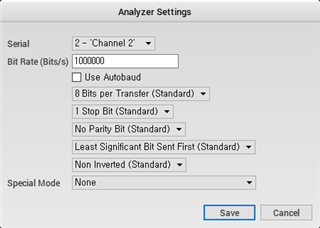

1. Logic Analyzer
2. Arduino serial plotter
    Baud rate 1000000

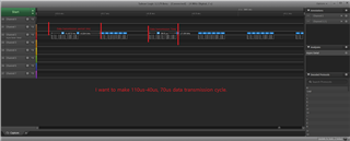

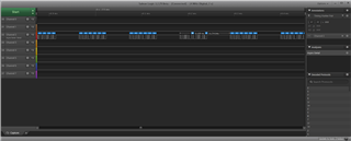

I have confirmed that data is transmitted well in the sampling cycle of 110us, but it fails in communication at 70us.
Data transmitted normally [sampling cycle 110us]
I want to change the sampling from 110 to 70. (Increase data sampling)
Dropped log out (sampling cycle 70us)

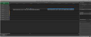

    Please check the third image.
     60us about Data transmission,
    I want to capture the ADC data 70us after data transmission and send it to uart. (For 10us spare, the shorter the better, but if there is no problem, I want to send it immediately.)
