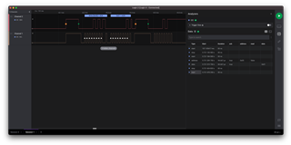

I2C gets stuck with -EBUSY if i2c_* function calls timeout on zephyr (NCS) for nRF52840
To reproduce this problemm Ive added a device to the I2C that does not respond to a read command.
The `i2c_read` call first returns `-EOI` (-5) and for every other i2c funcion calls it will return `-EBUSY` (-16).
Apparently it locks the i2c subsystem, a `sys_reboot` makes the i2c BUS available again.
I wonder if this is a known issue, and if there is a way of recovering the i2c subsystem? `i2c_recover_bus` is useless for this effect.
