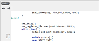

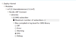

  • Sorry for the delayed response. Enabling the uart interrupt didn't make a difference, but changing the project settings as below did.
    We now receive the sms's but not consistently. The sms seems to always come through if sent during an active connection, but only intermittently on reconnect if sent during either gps fix or idle. If we reset the modem the sms's sent during these times also comes through.
