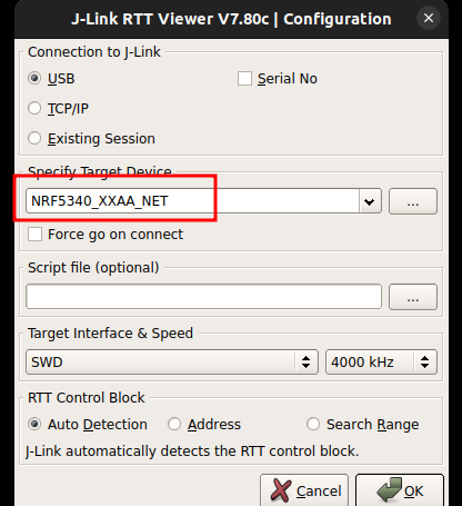

  • I verified here by having RTT logging enabled on both cores, but only opening one instance of the RTT Viever with the *_NET device selected.
    Does your RTT viewer configuration look like this when you try to get logs from the netcore?
    Here is the project I used for testing in case you want to give it a try:

  • Thanks Vidar.
    I'm quite sad to say that thanks to your example I realized that I completely miss the cpunet subfolder in the build, so my problem is that I cannot even build for the network core, so I think that's why I cannot access the RTT streaming.
    And that's a whole another problem. I'll find a solution for that. Thank you again!
