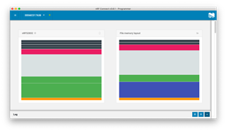

Another strange thing that I think is related this problem: after downloading this image to the device, nRF Programmer shows that there is no SoftDevice on it. See the screenshot attached - the blue area is missing on the figure on the right side.

  • Hi Tibor,
    Do you include the settings page in your merged hex file? I do not see it listed where you copy--pasted the mergehex commands. If not, then it would explain what you are seeing.
    If the above is not the problem, then perhaps you are seeing a known issue with the latest mergehex (10.12.1) where it can create corrupt images. Can you revert to an older version and see if the issue persist? Alternatively add all separate hex files to nRF Connect Programmer instead of using mergehex?
    If the issue persists then it would be good if you can test with the debug bootloader project (suffixed _debug) which includes RTT logging and upload the log here. In most cases the RTT log gives a good indication of where to look.
    Einar

  • Hi Einar,
    First, I simply tried adding separate hex files to nRF Connect Programmer instead of using mergehex, but the problem still existed.
    Then, as you proposed, I changed to the debug bootloader project to get more info - and for some strange reason, the process is working correctly with it. I don't know what's happening, everything else (firmware app, bootloader settings page, SoftDevice) is the same, do you have any idea?

  • Hi Tibor,
    It is odd that you see a difference between the debug and normal bootloader. However, this printout makes me spot a detail I did not see before. You specify --bl-settings-version 1, but the current version is 2 and based on the SoftDevice version I assume you are using a recent SDK version. Can you specify --bl-settings-version 2 instead when you generate the setting page?
    Einar
  • Thank you very much, Einar! Using --bl-settings-version 2 solved the problem :)
