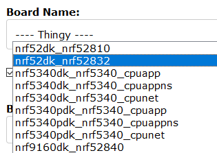

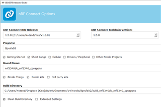

I'm in the process of evaluating nRF5340 but am new to Nordic chips and development environment. Im running Windows 10 and I installed nRF Connect 3.6.1 and installed the toolchain through it.
I managed to run the blinky proiect but have problems starting an own project.
I followed this guide
https://devzone.nordicsemi.com/nordic/nrf-connect-sdk-guides/b/getting-started/posts/nrf-connect-sdk-tutorial---part-1-ncs-v1-4-0

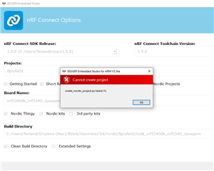

but when I build, I get this error
Creating solution Bprufa02.emProject
C:/Users/Notandi/ncs/v1.5.0/toolchain/opt/bin/cmake.exe -GNinja -DBOARD=nrf5340dk_nrf5340_cpuappns -DBOARD_DIR=C:\Users\Notandi\ncs\v1.5.0\zephyr\boards\arm\nrf5340dk_nrf5340 -BC:\Users\Notandi\Dropbox (Kiso)\BVerk\Geometer\V4\nordic\Bprufa02\build_nrf5340dk_nrf5340_cpuappns -SC:\Users\Notandi\Dropbox (Kiso)\BVerk\Geometer\V4\nordic\Bprufa02 -DNCS_TOOLCHAIN_VERSION=1.5.0 -DEXTRA_KCONFIG_TARGETS=menuconfig_ses -DEXTRA_KCONFIG_TARGET_COMMAND_FOR_menuconfig_ses=C:\Users\Notandi\ncs\v1.5.0\toolchain\segger_embedded_studio/html/configure_nordic_project_menuconfig.py

CMake Error at C:/Users/Notandi/ncs/v1.5.0/zephyr/cmake/kconfig.cmake:204 (message):
File not found: C:/Users/Notandi/Dropbox
C:/Users/Notandi/ncs/v1.5.0/zephyr/cmake/app/boilerplate.cmake:534 (include)
C:/Users/Notandi/ncs/v1.5.0/zephyr/share/zephyr-package/cmake/ZephyrConfig.cmake:24 (include)
C:/Users/Notandi/ncs/v1.5.0/zephyr/share/zephyr-package/cmake/ZephyrConfig.cmake:35 (include_boilerplate)
CMakeLists.txt:3 (find_package)
error: cmake failed
create_nordic_project.py failed (1)
I have spend several days on this problems and looked around but cannot find a solution. I would be very happy for any hint.

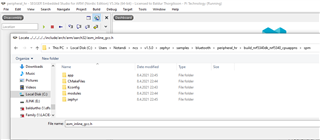

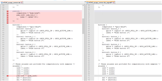

  • Hi Carl Richard
    #1
    OK, now I can see the file nrf5340_cpuapp_common.dts  :-)
    Looking at it, the fixes looks logical:

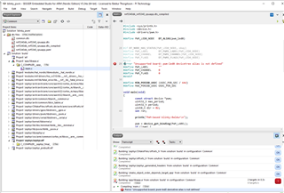

    But I still can not compile the project:
    ( I did restart Embedded Studio after the change)

  • Hi again!
    #1 Did you also try to reopen the project with a "Clean build folder"? This is usually required when changing the DTS.

  • Hi Carl Richard
    This was very helpful. I had cleaned the project, but  starting it over and checking Clean build folder resulted in compilation and a running program :-)
