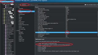

    The bad debugging likely has something to do with the debug optimizations set in the project after it was ported to SES. Can you check what the Optimization Level is set to in your project options. If it isn't already, try setting this to Level 0 for fast compilation and the best possible debug experience. Selecting None here might cause a less than optimal debug experience for instance.
    Simon
  • You may be right here. I took the hts example program (unmodified) and switched to debug, did learn to get RTT working by trial and error with the SDK_config.h settings (as well as the NRF_LOG via UART and putty) but a break point in the connection event would not be hit. Optimization was set to None. So I put it to 0 and the breakpoint was hit.
