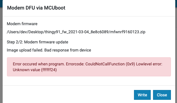

  • I was able to get the thingy91_nrf52_connectivity_bridge_2021-03-04_8e8c6089.hex programmed
    now I see device called thingy91 with two serial ports.. I then did a update modem
    with this file mfwnrf9160123.zip  and programmer does step 1 ok but I get error on step 2
    What I want to do is get the tracking working
  • Steve, happy to hear you were able to get the Thingy:91 visible in the device list.
    Can you please provide the nrfjprog and jlink version you are running (nrfjprog -v), and what version of the nRF Connect for Desktop?
