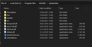

     When you are installing SystemView, it normally asks the path where to install it, you will find these files in those chosen installation path.
    On my Windows system it is as below
     You need to copy mentioned files from here  to your project folder
    morpho said:
    Global.h are located under external/segger_rtt. Is there where I should be copying the files to my project?
    This is under  C:\Program Files\SEGGER\SystemView\Src\Config for me and yes, you need to copy this to your project folder

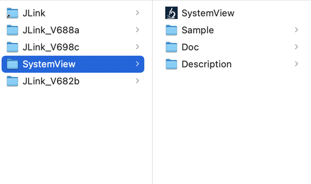

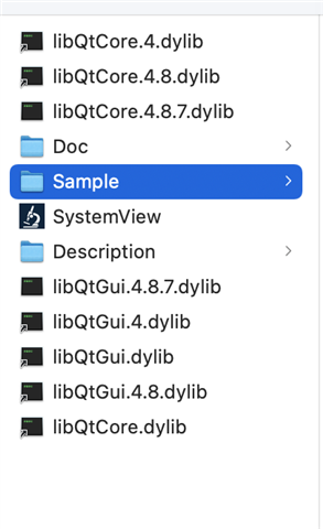

    Though my folder structure looks different than yours. Why is that so?
  • I am not sure, are you using different OS than Windows?
