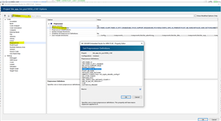

  • Hi, thanks for your help.
    In screenshot 1, I deleted CONFIG_GPIO_AS_PINRESET.
    In system_nrf52805.c, I deleted all codes which you provided above.
    However, the pin reset function on P0.21 still exists. Do you have any clue, please? Thanks in advance!
  • Please do a full chip erase after making the change to clear any existing NRF_UICR->PSELRESET settings
