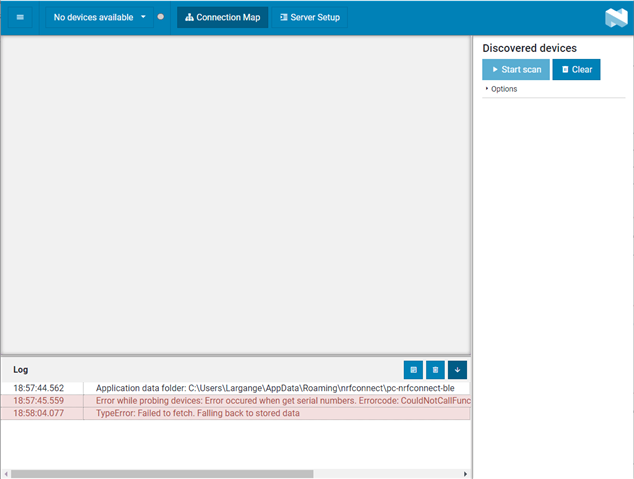

Hi,all
As said above, and the error was in the picture below, so why?if any one have some ideas.thanks a lot
Hi,all
which version of nrf connect for desktop and nRF chip do you have?
On the commandline can you try
> nrfjprog --recover
ok,
and i use the The latest version of NRF connect, i have nrf52832,and i use
s132 v6.0, SDK15.0
i'll reply you after i try in your way, thanks
