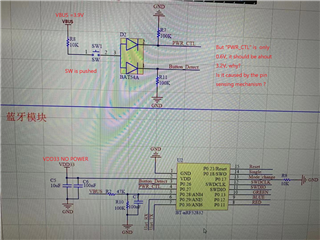

Now  I meet a problem: when the chip of nRF52832  is power off, but supplies power to one GPIO pin of the chip through resistor voltage division, then I found the voltage of GPIO is wrong. Is it caused by the Pin sensing mechanism? what is function the Pin sensing mechanism? How can I improve my schematic design?please give me your help,thanks a lot.
