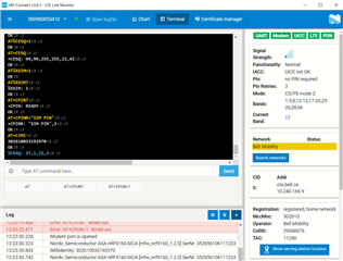

An older version tracking firmware (2020-04-09) and modem firmware (Ver 1.20) is reprogramed on the board, some LEDs (LED1 & LED3) starts to flash.  After a while, only LED3 is still flashing.  LTE Link Monitor shows a lot line of info.  It seems the cell network is working fine.  Please see the attached screenshot.

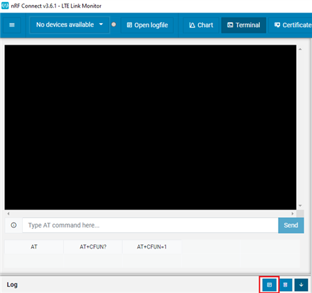

    Please attach the complete log from LTE Link Monitor, especially if you are getting a different error after updating the certificates. You can get the whole log as a file by clicking Open log file as shown below
