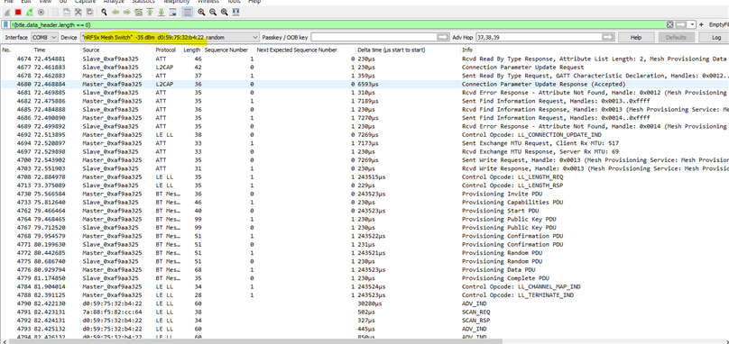

2) We could not find all the  provisioning pdu's  while provisioning(in the frames)in the Wireshark logs using nRF Sniffer(attached below) like Provisioning capabilities, Provisioning start and others.

    1. You can use any of our nRF5 SDK for Mesh example as the provisionee to test with the nRF Mesh App. I would suggest to try the light switch server example. It's located at \examples\light_switch\server
    2. If you are provisioning through nRF Mesh app, you would need to catch and follow the connection because the provisioning is performed via PB-GATT (BLE connection) not via PB-ADV (via advertising packets). To follow the connection you would need to select the advertiser in the drop down menu list in the nRF Sniffer menu in wireshark.
    If you want to do PB-ADV you would need to use either the provisioner we provided in the nRF5 for Mesh SDK or use the PyACI tool we provided on PC.
    3. Please follow #2. In addition, we don't usually use wireshark for debugging mesh, we usually use the logging on the node.

  • Hi Vithika,
    Could you please let us know what exactly you want to achieve by looking at the sniffer trace of the provisioning process? Do you want to debug something ?
    Do you have control over both side of the communication (provisionee & provisioner ) ?
    If you want to understand what's transferred in the provisioning process it's easier to use wireshark than looking at the phone's log. I attached here the screenshot when I do provisioning, note that I have to follow the "nRF5x Mesh Switch" in the Interface menu:
    1) If you want to see logging from the provisionee, you can enable logging inside prov_provisionee.c , setting PROV_DEBUG_MODE = 1. And enable logging for LOG_SRC_PROV when init logging.
