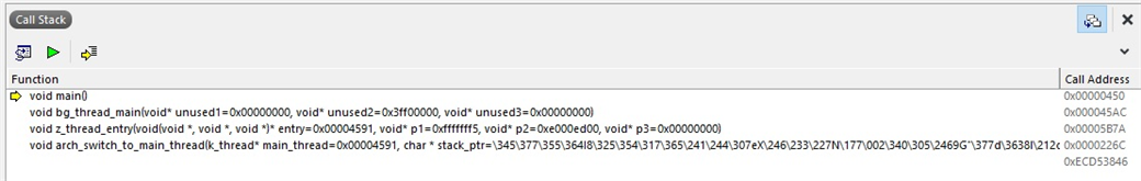

  • BennyC said:
    I have to ask, when I build and debug now it always stops at this line 12 of my main.c
    const struct device *dev = device_get_binding(DT_LABEL(DT_INST(0, max_max30101)));
    It seems like this is something that SEGGER does automatically at start up, it will find main and stop there. Similar to what Ozone does, as discussed here.
    The reason it stops at device_get_binding() instead of the start of main(), is because the code is optimized by default. I confirmed this by turning of optimizations (set CONFIG_DEBUG_OPTIMIZATIONS=y in prj.conf) and saw that it stopped at main().
