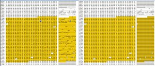

    I am developing a ZigBee coordinator based on the cli project. When using this project, “network data” such as network id, bindings, reports, etc. are saved in the ZB NVRAM.
    That was discussed in Case ID: 243345
    So far that works. After a power failure, everything works as before. I do not need to commission my Zigbee nodes again that.
    Now I would like to be able to read this "network data" and save it somewhere else. After my current working coordinator fails, I want to put this network backup data on a brand new coordinator. After that, I want everything to work as before. All nodes should be on the network without the need to commission them again.
    Currently I don’t exactly know what and how the stored data looks like. I compared the flash contend before I commissioned a node with the flash contend of after commissioning two nodes. I see that at 0xf7000 there is network data contend. After commissioning, I can also see the IEEE addresses of my commissioned nodes. Nevertheless, I need to know the structure of the saved data, to be able to put it on a brand new coordinator.
    I hope you understand my challenge and point me in the right direction.
    Lutz

    I can understand the need to create a backup of the network data in a case such as yours. Unfortunately, there are no easy solutions to do this, and no Zigbee specific functions in our SDK you can use. Creating a backup of the flash, or network data, is a security risk, as someone with access to this backup might be able to use this to make devices join the network without any additional activities, so it is not recommended. However, the easiest solution would be to copy the entire flash of the device and make a duplicate device with this. For this you can use nrfjprog commands, such as --readcode.
    The device configuration and network data of a Zigbee device is stored in the common dataset, and this dataset is 144 bytes. However, I cannot help you any more with where the network data itself is stored in flash, and how to get only this.
    As for the network key, you can use zb_secur_setup_nwk_key to predefine the network key. Then you can set it to what you want it to be, and will therefore know what it is. However, this should only be used for debugging or analysis of traffic sniffing results, and not for production.
