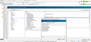

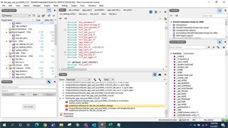

Please find below error screenshot,
    I don't think we have any ready examples that merges ble_app_blinky and ble_app_uart.
    If you can upload your project here, then I will take a look at what's missing.

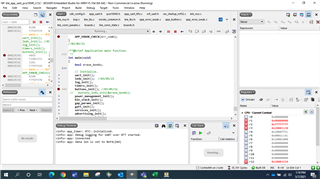

    Now both project builds successfully but enable to connect ble_app_uart to ble_app_uart_c. Also, the advertising, connection LED status not visible.
    Checked in debug mode both goes to NRF_BREAKPOINT_COND; in app_error_weak.c file

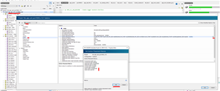

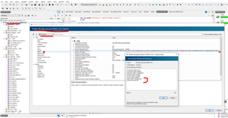

    After adding the 2nd service, you need to allocate more RAM to the SoftDevice. You typically will get something like this printed in the log when this is needed:
    <warning> nrf_sdh_ble: Insufficient RAM allocated for the SoftDevice.
    <warning> nrf_sdh_ble: Change the RAM start location from 0x20002AD8 to 0x20002AE8.
    <warning> nrf_sdh_ble: Maximum RAM size for application is 0xD518.
    <error> nrf_sdh_ble: sd_ble_enable() returned NRF_ERROR_NO_MEM.
    You then need to adjust this values, like this:
