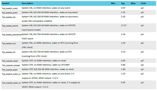

  • In the configuration I described above, VDD is internally 1.8V applied. (Because the "REGOUT0" register is 1.8V)
    If so, the voltage of the GPIO to wake up the nRF52840 must be less than 1.8V+0.3V. Is that correct?
    And what is the current consumption of Sleep (System off, NO RAM retention, wakeup GPIO) mode using the GPIO described in the your answer?
     Correct.
    That is the same as IOFF_RAMOFF_RESET, typical 400nA.
