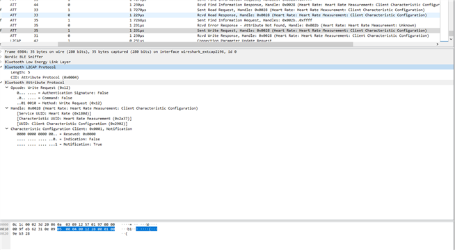

  • Hi Lukasz,

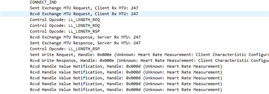

    The HRS_C was made to test with the HRM example. It was not made to work with all the HRM on the market as there could be incompatibility issue. (even thought BLE standard was created to avoid such incompatibility)
    Please confirm that you can use the HRM_C with the HRM example in the SDK .
    Regarding your concern about " BLE_HRS_C uses Generic Attribute Profile (0x1801):" it was just the interpretation of wireshark of the handle 0x0028 based on the service discovery process. I'm not sure why it confused and say it's Generic Attribute Profile when it's obviously not.
    From what I can see the command to enable notification are the same between the two traces:
    Same with the response.
    So I'm not so sure why the Garmin didn't send the notification.
    You may need to modify the HRM so that it would behave as similar as nRF Connect to make the Garmin HRM works.
    I can see that in the hrs_c there was MTU request and LL_LENGTH_REQ, you can try to turn that off in the HRS_C firmware. Turn off pairing as well.
    Try to match as much as possible to the nRF Connect trace.
    The service discovery I don't think would cause any difference here.

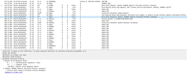

    edit2: Also, I think it's worth to note, that the Garmin has HAS the Body Sensor Location characteristic, just next to Hear Rate and the sniffer trace clearly shows an error (rcvd error response). So I think, that maybe this is the problem after all - the HRS_C is looking for both chars inside the "Gemeric Attribute Profile". I know they look the same as the Heart Rate char used by NRF Connect BLE, but there must be some difference that causes the problem.
    edit3: I can confirm it works with the BLE_APP_HRS example. But It doesn't solve my problem.
  • I removed the gatt files but it is still the same. Also I need to discovery process in my app.
    Anyway, can you try to explain why the services are recognized as insie the "Generic Attribute Profile"? They both are (body sensor location an heart rate). Looks like the dscovery process is wrong? When you view the HRM DUAL in nRF Connect BLE you can clearly see the structure of Services and I think it is in accordance to all standards.
  • My suspicion is that Wireshark recognized the service wrongly. Note that what you see there is just the interpreting of wireshark.
    That's why I suggest to find away to not doing service discovery.
  • f you can find away to not do service discovery from the phone
    I'm not doing a service discovery from the phone. My setup is the following:
    1. NRF52840 dongle with the HRS_C demo (with modifications like removed gatt files, turned of paring and bonding, etc)
    2. NRF52840 dongle with sniffer app
    3. HRM Dual from Garmin
    4. PC with Wireshark to sniff the traffic
    The other setup, which works, is:
    1. PC with NRF Connect BLE application (and correspongin NRF52840 dongle)
    2,3,4 as above
    So, the discovery process is done by the HRS_C app.
    Is there a way to modify it, so that it doesn't have to do service discovery and still connect to my HRM and enable notifications on it?
  • You can modify the HRS_C app to not doing service discovery (please look for the ble_db_discovery_start() function in the code) and then manually do a write request to handle 0x28 to enable CCCD notification.
    On PC with nRF Connect BLE application it will do service discovery automatically.
    Please note that the nRF52 dongle that corresponding to the NRF Connect BLE app also run the same softdevice as the hrs_c .
    So you can copy the whole procedure that the nRF Connect does to the HRM dual.

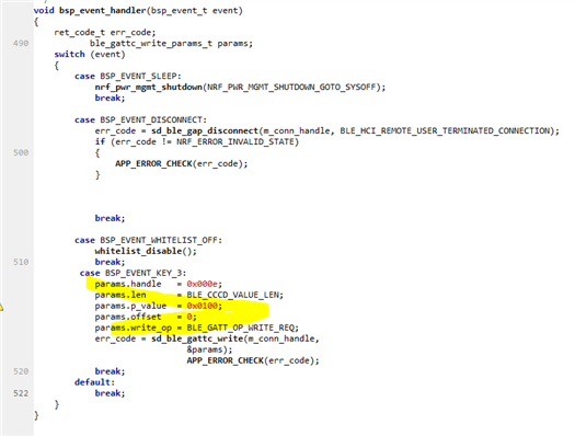

  • Hi Lukasz,
    I added this code into bsp_event_handler() and can enable notification without service discovery. When pressing button 4 on the DK it will send the write request.
    2133.main.zip
    You may want to modify the handle to 0x0028 as in the Garmin HRM. Also service discovery need to be disabled.
    Is there any chance that the Garmin HRM only response to the paired device and you may need to clear all paired device before it response  ?
  • Hi. I tried modyfing the handle to 0x0028 but with no luck. I think service discovery is disbaled. I removed the peer_manager entirely, so there is no pairing/bonding. Also I think pairing is NOT required as the HRM sends notofication to NRF Connect BLE app on my PC, and there is no pairing there.
    I deleted the whole pairing information from the device as well (I cleared the flash and installed the Softdevice and my program again).

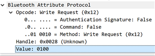

    Today I also tried calling sd_ble_gattc_write directly. I ended up just adding the following code to the ble_evt_handler (case BLE_GAP_EVT_CONNECTED:)
    err_code = nrf_ble_gq_conn_handle_register(m_hrs_c.p_gatt_queue, p_ble_evt->evt.gap_evt.conn_handle);
    ble_gattc_write_params_t params;
    uint16_t cccd_val = 1;
    uint8_t cccd[2];
    // originally it was reversed, but then it sends 0x0100, and it should send 0x0001?
    cccd[1] = LSB_16(cccd_val);
    cccd[0] = MSB_16(cccd_val);
    params.write_op = 1;
    params.offset = 0;
    params.handle = 0x0028;
    params.len = 2;
    params.p_value = cccd;
    err_code = sd_ble_gattc_write(p_ble_evt->evt.gap_evt.conn_handle, &params);
    The results are basically the same all the time.
    PS: I did try both 0x0100 and 0x0001. I understand it should be in little endian, but I just checked both ways to eliminate all possible mistakes.
    After your last reply I also skipped nrf_ble_gq_conn_handle_register and just used the m_conn_handle.The code is simpler but works the same :(
    I tried lookng for some information about garmin HRM specific BLE data, but coudln't find anything. I also tried removing the batter from the HRM itself to somehow reset it, but with no luck.
    I'm looking for some other ideas. Do you have any?

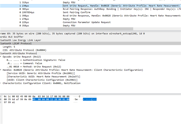

  • I would suggest to try using a phone or other central device to connect to the HRM and check if it can receive the notification.
    In the sniffer trace have you checked if the write request and the write response is exactly the same as when the nRF Connect on PC connected to the HRM ?
    If they are matched I don't see any reason why the notification shouldn't sent.
    Please try to test on the ble_app_hrs to check if you can get the notification. Then please try to test on other HRM device on the market. If it works with other HRM device then it's could be something tricky with the Garmin one.

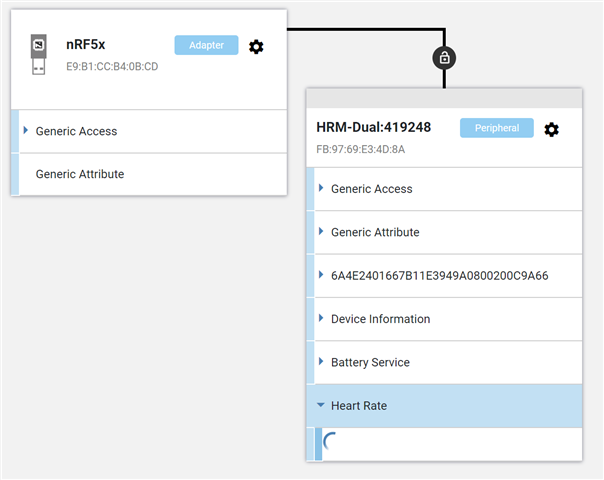

  • I did try to get notifications on my phone. I used NRF Connect BLE for my android phone and it works. I can enable and disable the notifications without any problems.
    However there is something strange happening to the HRM when I try to use the NRF Connect BLE on my PC now, Wireshark shows that the HRM sends notifications as soon as I connect to it from my PC. It sends them right away and I cannot stop it. I can't even expand the Heart Rate section - it freezes (see the screen).
    Is it possible that the HRM somehow remembers my PC? Or maybe it's the dongle that stored some information and enables the notifications instantly when connected?
    Is there a way I could have broken the HRM by sending some weird data to wrong handles? I guess it shouldn't be possible, but maybe?
