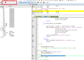

Some error occurred, i want to see some information in debug mode , but why can't i "step" to "app_error _save_and_stop" function?
In my main function, I just call a acceleration_read function to get data from the accelerometer sensor   and   call a NRF_LOG_INFO function.

So, i try to use debug mode to find out error information. I set breakpoint at nrf_delay_ms and idle_state_handle, as below.
i click on "step " in debug mode when the code call the nrf_delay_ms(5),  then the code went to "app_error_weak.c" and stopped as the picture below.
I tried to click the "step" button and see the error information in "app_error_save_and_stop(id, pc, info)" , but i found that after  "step" the code didn't go to  "app_error_save_and_stop(id, pc, info)"  and keil also changed its status,
I want to why the code can't go to the "app_error_save_and_stop"function (so that i can't get the error information)??
please help me,thanks.

    Please make sure that you have DEBUG defined in your preprocessor defines, like shown in the included image.
    This will write out a detailed error message and the generated error code to your log, if a non-NRF_SUCCESS error code is passed to an APP_ERROR_CHECK.
    From the other pictures you share I see that you have dropped logs. How big is your logs buffer, and how often is the NRF_LOG_PROCESS function actually called?
    You mention that the SoftDevice asserts when you try to use the debugger - this is correct. If you halt the CPU (like the debugger does) while the SoftDevice is enabled, it will miss its critical deadlines and assert. This is as intended, even though it makes stepping through the code infeasible while it is enabled. Since you are now debugging a non-BLE problem, you could therefore disable the SoftDevice for the time being, so that you may debug by stepping through the code.
