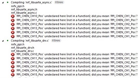

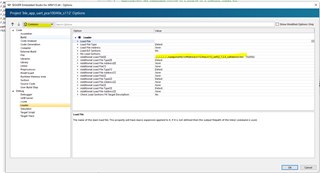

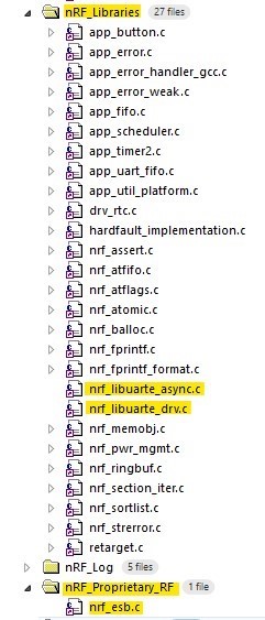

    I was able to find this guide Developing for the nRF52805 with nRF5 SDK and tried following it, but it looks like there are issues with the 17.0.2 version of the SDK.
    As user timuser said it would be great if it was possible to have just a simple working blinky/Hello World example natively made for nRF52805 that we can use as a starting point to build on.

  • Thanks, I was finally able to build the project and flash my external board.
