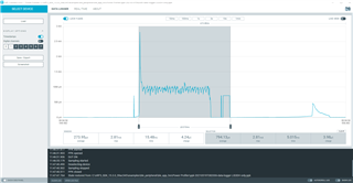

When reading the 32 latest XYZ values (192 bytes) from my accelerometer (LIS3DH) I see overall power usage of ~6.6mA for 7.3ms on my PPK2 power profiler.
When I profile the LIS3DH power usage in isolation I see that it is using ~1mA for ~5ms.
I have tested with my custom board and also with a breadboarded NRF52840 Dongle + Sparkfun LIS3DH. I see almost exactly the same on my custom board as on the breadboard with a NRF52840 dongle + Sparkfun LIS3DH
I do not understand why the NRF52840 is not sleeping.
I see ~11uA power usage before and after the TWI calls.

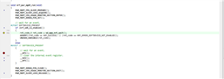

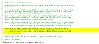

    When I look at sd_app_evt_wait I see this comment about interrupts. The 2nd note sounds relevant.
    Obviously I cannot step into sd_app_evt_wait.
    Could the calls to  nrf_drv_twi_* have immediately caused an interrupt?

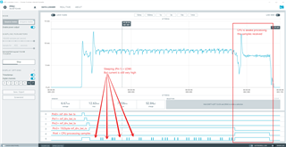

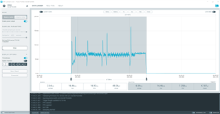

    I changed the code to perform the first 3 (of 4) twi calls synchronously, and the 4th call is the time-consuming one which I run asynchronously. I also hooked up the PPK2 logic analyser to show where the time was spent. See screenshot below
    Pins 0,1,2, show time spent in twi_tx, twi_rx, twi_tx.
    Pin 3 show time spent receiving 192 bytes in twi_rx
    Pin 4 shows the time spent processing the samples (moving averages etc)
    Pin 5 shows time spent inside nrf_pwr_mgmt_run. This is the most interesting because it shows that lots of time is spent inside nrf_pwr_mgmt_run() but the current is still high.
    I expected the current to drop to a few uA's while the NRF52840 is inside nrf_pwr_mgmt_run()
    I am confused by this result because it seems to show that the code is inside nrf_pwr_mgmt_run but the current is still very high.
