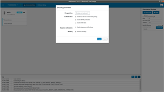

I use NRF52840 + SDK v17.0.2. My application relies on _gls example and mainly copies its security settings ( also uses peer manager ) except I use MITM protection for my characteristics and static pin code approach.
The root cause of issue is that behavior of NRF Connect for mobile (Android ) and for desktop differs. Our test app behaves correctly - I would say in the same way as NRF Connect for Android.
If shortly for Android ( NRF Connect app ) and iOS ( our test app ) during connection and bonding everything goes smoothly and I get expected result - I see pairing requests and system textbox for pin code input on both devices, after bonding is done I am able to connect without pin input.
The situation with NRF connect is different. It runs with 52840 usb dongle on Ubuntu, the version is 3.6.1 ( also tried 3.6.0 ). I tried both options: with automatic security response and manual - the result is the same - I can not get pin request on the screen thus device can not bond
Despite of MITM flag set in NRF Connect - anyway I get: Collector did not use MITM, disconnecting
Please advise what did I miss or what am I doing wrong. 2 log files are attached ( RTT output )
Thank you

NRF connect for desktop - FAIL flow

  • Tested with gls example without any modifications - result is the same as described above
    NRF connect for desktop + NRF52840-DK ( pca10056 ) - see attached log

    nRF Connect log:
    2021-05-20T16_28_50.764Z-log.txt
    Which version of the nRF Connect BLE app are you using? Could there be other factors here? Can you upload the log from nRF Connect?
  • Hi
    Sorry for delayed reply
    NRF Connect is recent one v3.6.1
    # NRF PC DONGLE open device
    2021-05-25T12:57:51.959Z INFO Device setup completed
    2021-05-25T12:57:51.960Z INFO Connectivity firmware version: ble-connectivity 4.1.2+Jul-14-2020-05-48-48. SoftDevice API version: 5. Baud rate: 1000000.

    # GLUCOSE connect
    2021-05-25T12:56:08.134Z INFO Connecting to device
    2021-05-25T12:56:08.202Z DEBUG GAP_EVT_CONNECTED time:2021-05-25T12:56:08.178Z connHandle:0 peerAddr:[address:C0:07:D8:6A:75:08 type:randomStatic addrIdPeer:0] role:central connParams:[minConnInterval:11_25 maxConnInterval:11_25 slaveLatency:0 connSupTimeout:4000]
    2021-05-25T12:56:08.231Z INFO Connected to device C0:07:D8:6A:75:08: interval: 11.25ms, timeout: 4000ms, latency: 0

    Screenshot from NRF Connect but did try all option variants
