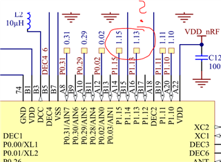

2.) In the docs and even in the video the pins are numbered like "30", "31" and so on. But the in ref-maunal and the schematic there ist port number AND the pin number , e.g 0.12, 1.15, how do i address 1.15, when i want to used it as a UART pin in the config overlay file?
    The pin numbers you provide is x if using P0.x and y + 32 if using P1.y.

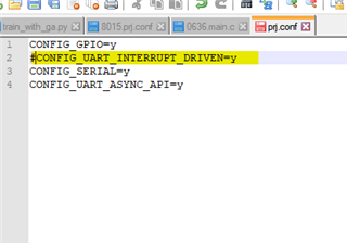

    After i changed the proj.conf to:
    CONFIG_GPIO=y
    CONFIG_SERIAL=y
    CONFIG_UART_ASYNC_API=y
    there is an address connected to the handler, but there is still now traffic on the pins (i used tx-pin = <0x14> and rx-pin = <0x18>). I've checked this with a logic analyser.
    As i understand it, i only need the uart_tx() function to send something, am i right? Or is there another config that i have to set.

  • Hi Sören,
    When you use CONFIG_UART_ASYNC_API=y you also need to specify uarte in the device tree, so referring to nrf\samples\bluetooth\peripheral_uart\ again you can look at prj.overlay (simply copy that to your project).

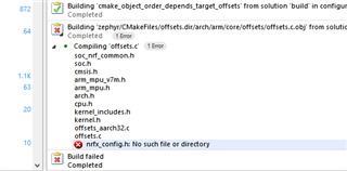

  • Okay,
    after i copied the prj.overlay file in my project, it compiles no more...
    nrfx_config.h is missing...
    But, why do i have to copy a file prj.overlay in the project with the same content as the zephyr.dts file??? I think i don't have understoond this Config-File concept at all... and yes i have read the docs, multiple times!!!
