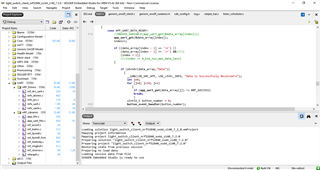

  • Hi Hung,
    I did not use the "app scheduler".
    The "timer scheduler" was added in the client example by default in the Core folder.
    I have just added the drivers and libraries of UART into the client example as you can see in the image.
    As I said when I change the priority of the UART it works fine.
