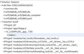

One of the things I find most tedious about any embedded environment is having to deal with the tool chain.  Is it just me or is the nRF tool chain / sdk getting heavier and more complicated with the passage of time?  I think the reasons include that they want to make all of their projects easily set up to support multiple platforms.  I get that, but it's not really a concern of mine, so all that stuff just seems to get in my way all the time. I think the complexity is underscored by looking at the questions people have about creating new projects.  The vast majority of answers tell you to find a close-enough example project and clone it, then work from there.  So this morning I tried exactly that.  I selected "open nRF SDK Project" and selected iBeacon on an nRF52840_DK.  What it did was opened up a project with no source files:
To see some actual source code I have a few choices: "Open file in project" and "Open file in solution."  There are no significant files in the 'project' but the 'solution' does have a main.c but it also has a dozen or two files named arch.c.  I opened main.c and then it showed me that maybe my file really was in the solution after all:
