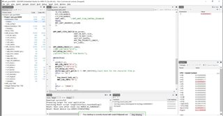

Hi, I am new to NRF and segger embedded studio.
So I want to send temperature sensor data connected with nrf52840 DK to the Murata1_SC  device using UART.
The data will be sent using AT Commands.
So how to send AT Commands in Segger embedded studio.
Thank you for the help in advance.

    Here is the code I have created till now

  • Thanks for the help, I have read the threads and got some information, but I have multiple commands to send and have to wait for their responses.
    .First, send a command and then wait for a response.
    Could you please tell me how much timeout should I keep for waiting for the response
    send_AT_Command();
    timeout();
    if (received_srting == actual_string)
    print(received_srting);
    else
    print("ERROR",received_srting);
    send_AT_Command()
    timeout()
    so on.............
    I think this will the format, but I don't know how to write in Segger
    Please help me with the format.

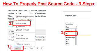

    please remember how to properly post source code:
