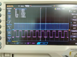

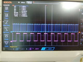

i use a timer for sampling of 3 adc channels, (4 times * 3 channels = 12 samples)
i put a pin to toggle in the 32Khz timer handler and i see in the oscilloscope then when i am running with the debugger i get a delay in the 8th event
but when running without a debugger i catch all events
what can be the reason ?
p.s. i am using SEGGER
    When you say 'running with the debugger', do you mean that you are stepping through the code, or that you are letting it run continuously? Please be advised that the debugger will halt the CPU at every instruction whenever you step through the code, which may cause behavior that looks abnormal when working in pair with peripherals that work independently of the CPU.
    Could you possibly share some code of here, so I may see the event handler that suddenly is delayed?
    It would also be great to see a capture of the oscilloscope when this happens. Is the delay you observe always the same, or does it fluctuate in length?

  • do you mean that you are stepping through the code, or that you are letting it run continuously
    no breakpoints, the code runs, i observe variables in a watch that is updated twice in a second, i change it to never thinking it might change something but it didn't
    this oscilloscope results :this one is when running the code with the debugger (the blue line) you can see that there is repetition of every 8th entry to the timer handler and it does not miss an entry but the 8th gets a bit late and the 9th is right after it
    this oscilloscope result is when running without the debugger, i start the program with the debugger and then i stop the debugger before getting to the measuring section with the timer

  • Hello Ziv,
    Thank you for elaborating and clarifying - this is very helpful!
    This is an interesting behavior, especially so since it happens periodically on the 8th event.
    I think the issue here lies with the fact that the pin is being toggled by the CPU, which can be impeded or affected by the debugger. If the pin toggling was done through PPI there would not be any way for the debugger to delay it.
    If you setup a GPIOTE task to toggle the pin - without any interference from the CPU - and then connect it to a timer CC event through PPI, you should not see any such delays.
