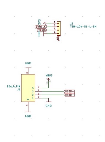

Hi a bit a noobie here, but I can't connect to my nRF52840 on my custom board that I made. I have tried both an ST-link V2 with openocd, flashing it into a black magic probe, and everything else I could think of. When that didn't work, I figured it would be easier wwith a J link, so I picked up a j-link edu mini from ada fruit and have been trying that. I have tried nrfjprog, J-link commander, and arduino and they all have not been able to connect to the target. I make a connection to the J link, it is only connecting to the target that fails. I tried to produce a log with nrfjprog --recover --log, but it either isn't producing a log file or I can't find it. I am using this nRF52840 module https://freqchina.en.alibaba.com/product/62501832603-810441729/bluetooth_5_0_module_mesh_module_zigbee_ANT_nRF52840_module_PTR9818.html. I have Swclk, swdio, vdd, and ground coming off the module into a 4 pin SWD connector, and connected those to my J-link via SWD.
  • VTreg is getting 3.3V when measured between that and the ground pin.

    I don't have any experience with this module, nor can I prove that it's actually a real one. We have seen that people have bought non-legit from sites such as Alibaba and Ebay and then have connection issues.
    Nevertheless,
    Assuming that it's actually a real nRF inside:
    For SWD to work you need to route out the:
    • VCC
    • SWDIO
    • SWDCLK
    • RESET(optional)
    You also need to make sure that the nRF is supplied when you try to debug. It seems that you are supplying the nRF 3V3 via the debug interface, but I can't see where the supply is connected to the debugger?

    Hi I have the 3V3, SWDIO, SWCLK, and ground coming off the board with a 4 pin header. I connected 3V3 -> Vref, SWDIO -> SWIO, SWCLK ->CLK, and GND -> GNDP
     Ok perfect, in addition to this you need to make sure the board is supplied externally while trying to connect to it.
