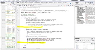

Hi All,
I am developing product using nRF52840 and SDK nRF5_SDK_for_Thread_and_Zigbee_v3.0.0_d310e71.
This product is basically, using the Thermostat cluster and Zigbee protocol to communicate with the Zigbee gateway.
So, I referred light_bulb example and followed steps to enable "Thermostat cluster and attributes".
I have included the respective files also but I am unable to execute the below callback function case statement,
static zb_void_t zcl_device_cb(zb_uint8_t param)
    zb_uint8_t                       cluster_id;
    zb_uint8_t                       attr_id;
    zb_buf_t                       * p_buffer = ZB_BUF_FROM_REF(param);
    zb_zcl_device_callback_param_t * p_device_cb_param =
                     ZB_GET_BUF_PARAM(p_buffer, zb_zcl_device_callback_param_t);
    NRF_LOG_INFO("zcl_device_cb id %hd", p_device_cb_param->device_cb_id);
    /* Set default response value. */
    p_device_cb_param->status = RET_OK;
    switch (p_device_cb_param->device_cb_id)
        case ZB_ZCL_SET_ATTR_VALUE_CB_ID:
            cluster_id = p_device_cb_param->cb_param.set_attr_value_param.cluster_id;
            attr_id    = p_device_cb_param->cb_param.set_attr_value_param.attr_id;
            if (cluster_id == ZB_ZCL_CLUSTER_ID_THERMOSTAT)
                uint16_t value = p_device_cb_param->cb_param.set_attr_value_param.values.data16;
                NRF_LOG_INFO("thermostat local temperature: %d", value);
                if (attr_id == ZB_ZCL_ATTR_THERMOSTAT_LOCAL_TEMPERATURE_ID)
                    local_temperature_value(value);
            else
                /* Other clusters can be processed here */
                NRF_LOG_INFO("Unhandled cluster attribute id: %d", cluster_id);
        default:
            p_device_cb_param->status = RET_ERROR;
    NRF_LOG_INFO("zcl_device_cb status: %hd", p_device_cb_param->status);
Also, I am attaching code for reference please let me know what else I forgot to enable the functions. It is urgent for me to solve this issue.

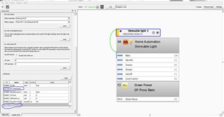

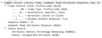

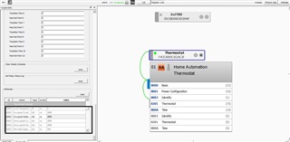

  • Hi Marte,
    Thank you for the details,
    As of now, sending custom command is pending. I will work on this in some time.
    But current requirement I am trying to enabled the required attributes list. With reference to your code and other I have created extended list also.
    But unoccupied, min and max, local_calibration and etc are not getting highlighted from thermostat cluster. And also Battery percentage attribute also facing same problem. they are not getting highlighted and these are must attributes (mandatory ids).
    I have tested in SDK 3.0 I am getting highlighted below points but in SDK 4.1 i am facing this issue. Let me know why?
    Below is the image attached for both cluster. And also my thermostat.h file please check what is wrong. Why I am not getting these attributes highlighted.
    0508.zb_zcl_thermostat.h
    5807.zb_zcl_power_config.h
    Thanks and regards
    Rohit

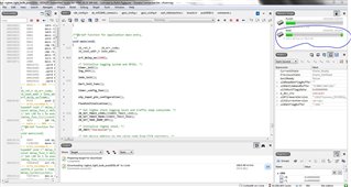

  • Hi Marte,
    Update from my end,
    As per your suggestion, I made the code in SED configuration. I have shared my main file in previous post. - Let me know any changes.
    But with this SED, configuration what I observed is with Dev-kit and Radiator base (STM) board I am getting 1mA current. Which is comparatively less than what I was getting previously.
    Now I would like to do further reduction in current including nRF dev-kit and STM8 board I need almost 60uA and only nRF i need 30uA.
    So, I decided to add ram retention also here along with sleep. Please find the attached image of my memory usage and let me know how I to power down unused ram section.
    I request you, please give your feedback as early as possible on this.
    And also, I would like to know can we use system off in sleepy end device and wake up on GPIO interrupt. I mean device should work as sleepy end device as well as system off mode. It should wake up periodically like SED and wake up on system off mode? Let me know your feedback on this.
    And is there any update from developer regarding system wakeup on zigbee command? I am getting pressure from team to resolve sleep issue.
    Thanks and Regards
    Rohit R

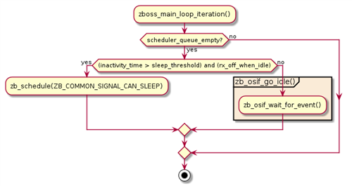

  • Hi Rohit,
     I have already answered this, and explained that this is not possible with SED. With devices that are not SED, this will happen by default if you are using zb_osif_wait_for_event() to reduce power.
    • SED: A Sleepy End Device will go into sleep mode, and not only low power mode. This will, among other things, turn off the radio. So the device cannot receive Zigbee packets, as the radio is not receiving anything. Sending a command to wake the device will do nothing, as it will only receive the command after it is already awake. This is part of the Zigbee specification, for RxOnWhenIdle = false devices (some places call it RxOnIdle = false or RxOffWhenIdle = true).
    • Non-SED: Calling zb_osif_wait_for_event() makes the device go into low power mode. This is functionally the same as a single call of __WFE() instruction (wait for event). The CPU goes into a low-power state until an event occurs. Any interrupt occurring between zb_osif_wait_for_event() calls will wake up the device, same as with __WFE(). The radio is not turned off, so the device will still receive Zigbee packets. Receiving Zigbee packets will be an event, so it will wake up.

  • Hi Marte,
    Thanks for the response.
    - My point here is, I want less current consumption for my device it should be 30uA. As per your suggestion we tried SED because zb_osif_wait_for_event(); Didn't worked. It gave us current 3.9mA.
    So, Till we get developer feedback on waking up device using Zigbee command. We tried SED config. And it gave us some better result around 1mA. But again this huge my target is 30uA.
    - That's why asked any update from Developer for this? If the waking up device using Zigbee command gives us better result in current consumption I will definitely use that not SED. On other hand after configuring SED if would resulted me in uA (micro Ampear) then I would go ahead with. I didn't bother for waking up on Zigbee command.
    - Point is, using SED or zb_osif_wait_for_event() not gave me less current. In document typical value mentioned. Also, some points regarding System ON, no ram retention but how to do that no explanation. System Off also same. Only wakeup on reset or GPIO interrupt that also not help me here.
    Then how to reduce current?? We trying different different ways but still same result. Current not reducing below mA.
     As this feature is only available in v4.1.0, you must implement it yourself in v3.0.0. As I stated before you should look at the function zigbee_power_down_unused_ram() in zigbee_helpers.c in v4.1.0 to see how this can be done. After implementing the function, you should call it right after setting SED with zb_set_rx_on_when_idle() in main().
    - I saw some post and suggestion followed below to configure the same.
    NRF_POWER->RAM[0].POWERCLR = 0x3;
    NRF_POWER->RAM[1].POWERCLR = 0x3;
    NRF_POWER->RAM[2].POWERCLR = 0x3;
    NRF_POWER->RAM[3].POWERCLR = 0x3;
    NRF_POWER->RAM[4].POWERCLR = 0x3;
    NRF_POWER->RAM[5].POWERCLR = 0x3;
    NRF_POWER->RAM[6].POWERCLR = 0x3;
    NRF_POWER->RAM[7].POWERCLR = 0x3;
    NRF_POWER->RAM[8].POWERCLR = 0x3F;
    - As per our study I commented RAM[0], RAM[1] and RAM[2] and set RAM[8] = 0x3 then able to run my code.
    - And, if i just comment RAM[0] and RAM[8] = 0x3F as per one of nrf engineer post, I am not able to run code. IT enters into hardfault.
    - Okay, I will follows your steps. Use 4.1 to port in 3.0 SDK.
    I will come back to you regarding this.
    - Yes, please I will wait.
    Thanks and Regards
    Rohit R
  • Hi Rohit,
    Can you please give some more information about what your project is doing when you are measuring the current and how you are measuring it? You say the device has joined the network, but is it performing any other actions while you are measuring the current consumption?
    You can also check out our guide Measuring current, and I recommend reading the note further down on that page. Additionally, it is suggested to cut SB40 to put P22 in series with the load, as explained in Preparing the DK. You should also set SW6 to "nRF only".
    When performing current consumption tests earlier, our developers have managed to get sleep current consumption down to 1.6-3.3 µA, depending on the amount of RAM retention. This was when the device had joined and was not performing additional actions, but being in sleep mode. However, it is difficult to compare with your results without knowing more about your test setup.
    Please read what I wrote in my previous reply about this. If you want to get the lowest possible current consumption, you should use SED. You will not get lower current consumption when not using SED. The difference between SED and non sleepy devices is that with SED the radio is turned off and does not receive or send packets. This greatly reduces current consumption.
    If you are using SED but does not see a significant impact on the current consumption, then it is possible the device does not go to sleep as it should, or that it wakes up very often.
    Also, the current consumption in SED applications is further optimized in v4.1.0 of the SDK, so you it is very likely you would get a lower current consumption using that version.
    Please read my previous replies. I explained clearly what the parts of this configuration means:
    • System ON: This means that the chip is in system ON, and not in system OFF, which means that the chip is in a regular state ready to run, and that the CPU is in sleep mode. The CPU is in a WFE (waitinf for event) call, and will wake when there is an interrupt. This interrupt is typically the RTC clock, but with 1 μA. the RTC is not in use.
    • no RAM retention: this means that the RAM is not conserved, and will practically mean that there is no code running on the chip.
    You get System ON when the CPU is in sleep mode, so either when a SED goes to sleep, or when calling zb_osif_wait_for_event(). You must have some RAM retention, as without it, your application cannot run, but you can power down unused parts of RAM, as I have explained previously.
    In both the case of SED and non-SED devices, the stack calls zb_osif_wait_for_event(), which will behave like a single call of __WFE() instruction, from a functional point of view. So if an interrupt occurs between zb_osif_wait_for_event() calls, the device will wake up. Thus, you can implement GPIO interrupts in the same way as you would with WFE (wait for event). You must enable GPIO, configure a pin for input, and configure it to give an interrupt on pin change. An example of how you can do this is to create a gpio_init functions as follows:
    static void gpio_init(void)
        ret_code_t err_code;
        err_code = nrf_drv_gpiote_init();
        nrf_drv_gpiote_in_config_t in_config = GPIOTE_CONFIG_IN_SENSE_TOGGLE(false);
        in_config.pull = NRF_GPIO_PIN_PULLUP;
        err_code = nrf_drv_gpiote_in_init(PIN_IN, &in_config, in_pin_handler);
        nrf_drv_gpiote_in_event_enable(PIN_IN, true);
    Then you can call this function in main() during initialization. You must remember to define PIN_IN as the pin you want to use for interrupts. You can also check out the GPIOTE driver for more information.
    Marte
