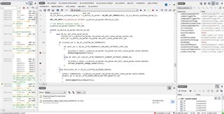

  • Hello Marte,
    Yes, it is exactly same.
    My declaration and your declaration in matching.
    I have attached the image, where you can see the highlighted part when I run the code. lines are not enabling.
    Can you verify is it correct?

  • Hi Rohit,
    One thing I see is that you have
    if (cluster_id == ZB_ZCL_CLUSTER_ID_THERMOSTAT)
    else if (cluster_id == ZB_ZCL_CLUSTER_ID_THERMOSTAT)
    Here, your code will always go into the first if when the cluster is the Thermostat cluster, and will never enter the else if on line 421, since when you use if, else if, and else conditions, it will only enter the first condition that is true, and will ignore all the rest. You should instead do something like this, where both MIN_HEAT_SETPOINT_LIMIT and CURRENT_SETPOINT_CHANGE are under the if ZB_ZCL_CLUSTER_ID_THERMOSTAT:

  • Hi Marte,
    Sorry for this inconvenience. I am not getting reply option to your latest feedback. I don't know what is wrong.
    And to last post reply -
    1. Yes, I have tried only current_setpoint_attribute() function also then also same problem. code line are not executing as marked in previous image.
    2. I tried your suggestion also but still the same problem. You find the attached image where i am not able to put break point.
    Should I share the code. but is same to last only thing is I have enabled more extended attributes.
